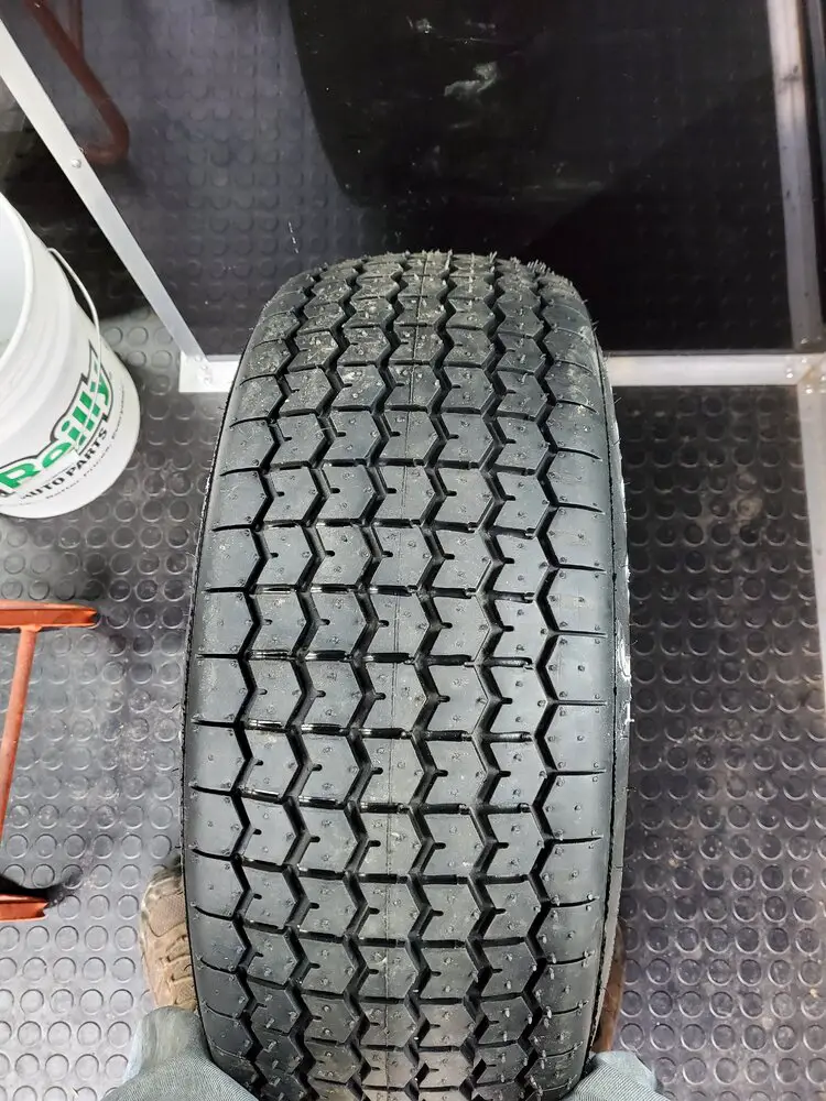

Picked up 4 new Hoosiers yesterday after work and mounted them on the 4 stock rear wheels so I can get them grooved up before the new bling wheels get here.
I'm trying something different this time and going with the P1000 version instead of the Turbo version I currently run. Both are labeled the same size but the P1000's section width is .9" narrower. It's basically one tread block difference. Both are M500 compound so no difference there. My reasoning for going with the narrow tire is twofold. First is the obvious weight difference. Smaller is lighter, right? Second is ground pressure. A slightly smaller contact patch puts more PSI to the ground and in theory should give me better traction, right? Guess I'll find out in a few weeks! 😮

Start of the grooving I'm going to run on the rear tires...

That 1 small groove on every other tread block won’t do enough to help. You could drop 1/4 pound of air pressure and gain more than that.

No, no it won't. What happens to the tread of a tire that is run to low on air pressure? Does it not wear out the outside edges and leave the middle practically untouched because of the tire cupping up in the middle? Cutting the radial grooves in the edges helps the tire flex in that area so it maintains a flat even contact patch all the way across the tire at lower air pressure. Dropping it a 1/4 pound does not have the same effect and would actually hurt performance. But you do you....
