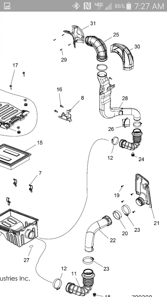

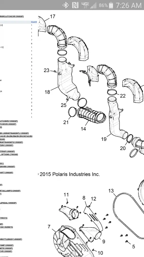

I noticed that we do have a small area where the bed meets the back of the seat in the center. I'm wondering about if maybe 1 of the 3 snorkel tubes that polaris molded for the highlifter edition ranger will fit. A 3" diameter pvc will not fit but maybe an oval piece will? I need to find someone with a hl edition ranger to see. See parts 18, 19, and 28 attached in the photos

The front one is connected to the back one and you would have a lot less cutting by eliminating the front one and snorkeling the rear one. I can tell you from experience that's not the biggest concern. I floated mine in the river and the only place we had water was the rear diff and the sub transmission only. Changed all the fluids in the rear diff twice and changed the oil in the sub transmission 4 times to clear up. If you are doing anything in deep water i highly recommend figuring out how the water gets in the sub transmission and obviously snorkel the breathing tubes on the diffs as well.

The only way that I've seen to snorkel is up front. I worked for 3 hours trying to snorkel between the bed and the seat with 2" pvc with nothing to show. I hope someone redoes an airbox so we can go straight up from there. That airbox is huge.
View attachment 8965 View attachment 8966
You might be on to something, Part #19 turned around the other way, just might fit. Everyone keeps finding things for me to spend $$$ on, another episode of H.A.D. is just around the corner.

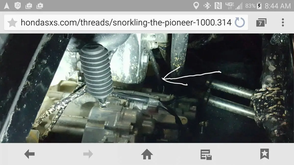

Fyi, you need at least one more. A vent for the motor.

That vent goes straight down and doesn't need to be snorkeled in my opinion. Think about taking a straw and placing your thumb over it and pushing it vertically down into the water. The water will not go up into the straw.
I have been in water over the seat and not had water go up that tube.
I had an 87 foreman that had a vent fron the fuel pump that got clogged that went straight down too is the only reason I say that
39,130
Maybe we should better understand what that tube is. I had the same thing on my P700 and dozens of deep water crossing never gave me trouble.
Anyone know exactly what that is? Is it a crankcase vent that would maintain pressure while the engine is running? It's a rather large diameter tube, why did Honda use that large tube? Would there be an adverse affect by raising it higher or reducing the diameter?
Also, all the vents on the pioneers go up, but this one goes down. That makes me wonder why, if Honda thought that was needed to go down, should we raise it higher?
There may be something to learn here.

One option is to get a longer piece of hose and make a few loops in it pointing down. Thats how I ran all my vents for my outlander
A bellow will not work on a crankcase vent there is constant pressure fluctuations and a small amount of blowby fron the cylinders when running. A longer vent hose or tied into air box which the P1K alread does fixes that concern. I'm not sure what downward hose you are referring to got pictures?

It's the one I attached with the arrow pointing toward it

It will act just like the straw concept mentioned. Mine got missing on my 700. Water pump started to leak few mud trips later.
