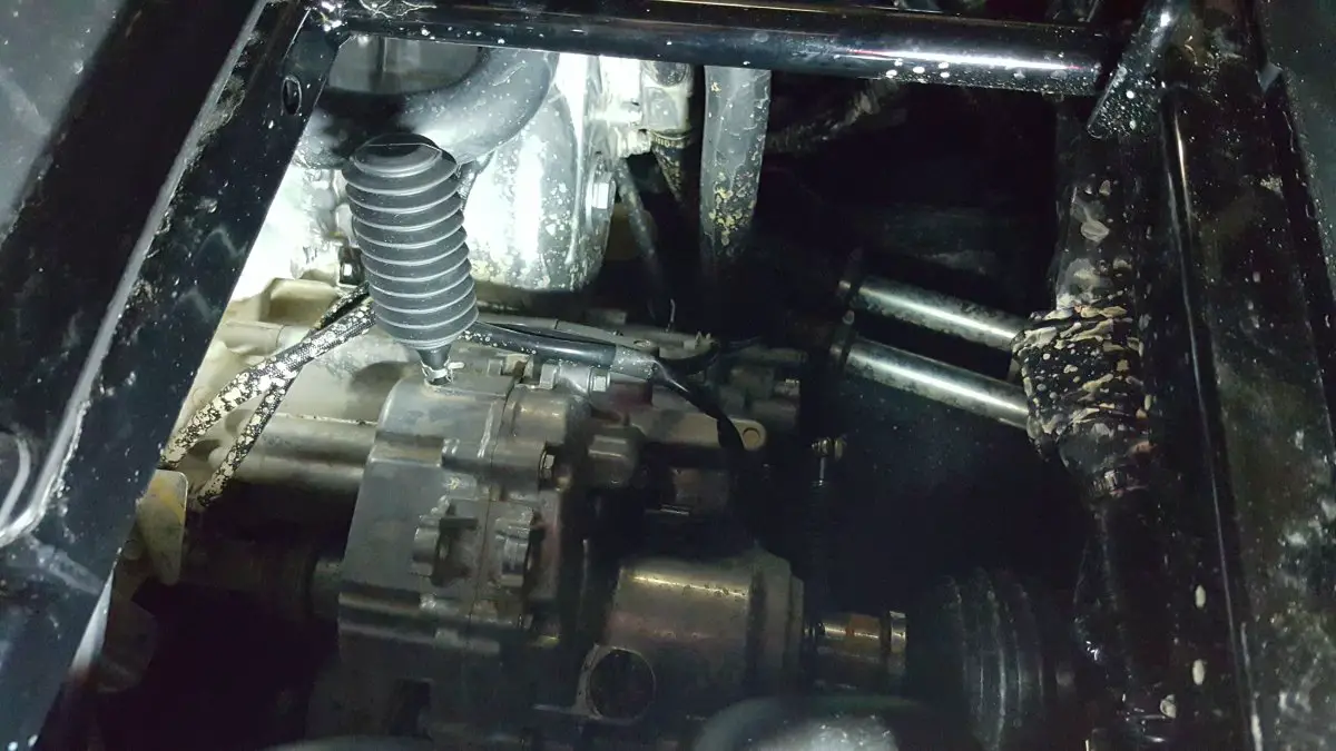

I'm thinking about putting some snorkel kits together. If you would be interested let me know. I think I can get this shipped for $120 The hose is 2" and 3/16" thick walls you cannot smash it by stepping on it. I tested mine this past weekend. It does make the machine a little louder but has a good tone. It connects where the factory Intake connected to the air box. I would include hose tie wraps and fittings and the red filter. I could do 100.00 if you didn't want the filter. The red filter is just to stop leaves, grass ect. OEM filter is still in place. People have used panty hose or this purpose as well. I removed the back floor board to install it takes about 20 minutes to remove the floorboard. Total install about 1.5 hours It is very similar to the one on eBay but the hose doesn't have to be smashed. And a lot cheaper. They are running 200.00 average on eBay. If I get some interest I'll get some materials together and see what it would cost to ship, and come up with a good price. I could also include tubing to vent the fuel tank, differentials, and fan thanks for looking!

How is the bellow attached? Is it screwed in and water tight?
Long term the bellows weren't allowing enough expansion for some of us. In the end we just extended the vent lines.
But the bellows did just slip on tightly .
