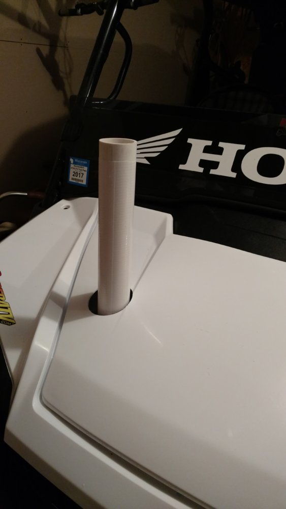

Just did mine. Used 2" PVC,a 2" rubber hose connector from Menards. Greased it up with dawn and worked it onto the inlet under the hood and cut a 3.5" hole in the hood. I'm going to get an elbow piece to top it with when I get back home and cut it like an exhaust stack pointing at the windshield. Total cost 6.75 and the hardest part was cutting the hood in the right place. Anyone care to share how they got the hole in the hood in the right spot?

And now looking at it, I need to paint the pipe black and cut about 6" off if it.
I think somebody said they used a laser pointer centered in the intake to mark the spot.
