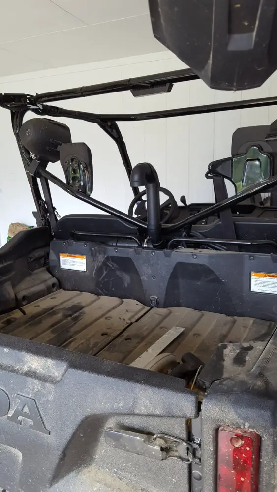

might have to go a different route... i have the two piece windshield and the clamp is gonna be in the way
You dont. You just need to raise the pvc straight piece coming out of the cup holder just enough them put the 22 degree elbow on just at the right spot so the windshield will fit. I'm gonna get a windshield sooner or later and when I redo mine I'm gonna have to take more time to make sure it fits.
It's gonna take a little more time and measurement but it should work

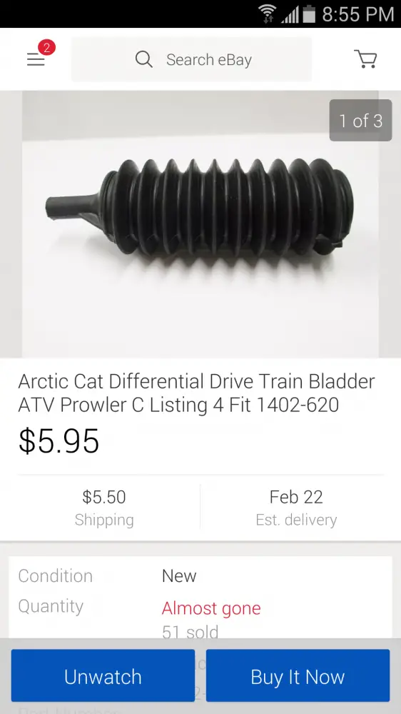

didn't you go with the Polaris (softer material) bellows?
Gotta paint now
Scooterchris
No longer active.
Dec 25, 2015
396
237
wont be able to get bellows before this weekend... what size is the hose
Shoot idk. The diff are tiny little hose. The sub trans and fuel tank are 1/4 inch I believe.

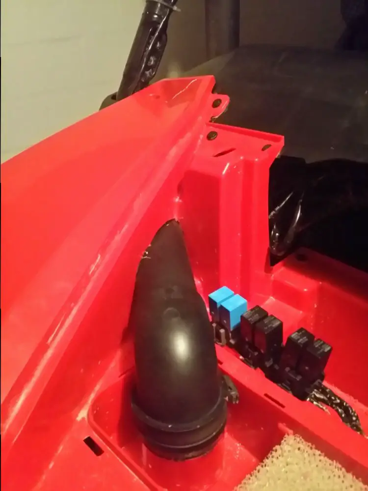

Looks good. Let's see what you did in the hood area
Scooterchris
No longer active.
Dec 25, 2015
396
237
same as u under the hood just a bigger hole because of corona
Hahaha I'm glad I'm not the only one. I was sipping on some bud light. By that time I could barely work the dremel. That's why my buddy ended up building it

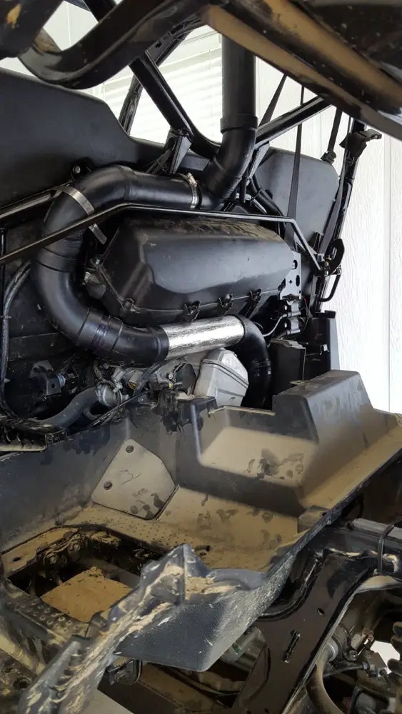

Can you plz give me some info on how you made this connection. Tried to find a rubber boot to fit but could not find one. The one under the hood that is. I am reading put a 2 inch rubber boot inside the stock snorkel pipe riser under hood.
Dasmoeturhead
This only cost me a couple of hose clamps,zip ties,and a hose I had laying around.
