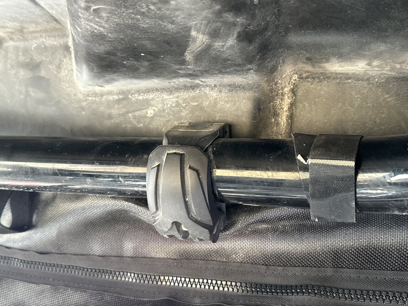

I purchased a soft cab enclosure and the problem I’m having is getting it to attach to the rear tube around the roof clamps.
Are there redesigned clamps for a Honda roof?
The rear window piece won’t come up high enough to keep even moisture out the way it appears
Thanks for any answers.
Maybe I’m just overlooking the obvious
Jim

Hawk53 this clamp is my issue.
The exterior didn’t want to stay up to where the roof would actually cover the enclosure.
I came up with loosening the clamps and pinching the top of the enclosure between the roof and the roof clamp to make sure it would stay up.
It just doesn’t look right to me but it will work.
Thanks

Doesnt look like it has a window or is there another zipper?

Mine was the same way. I took the screws out of the clamp, poked some holes in the fabric, and ran the screws thru the fabric of the back panel into the clamp.
I never take my roof off, so it isn't an issue.
Honda brand roof, clamps, and back panel....

......poked some holes in the fabric, and ran the screws thru the fabric of the back panel into the clamp.
This, heat up a nail or something similar, that will melt the fabric and keep it from fraying
