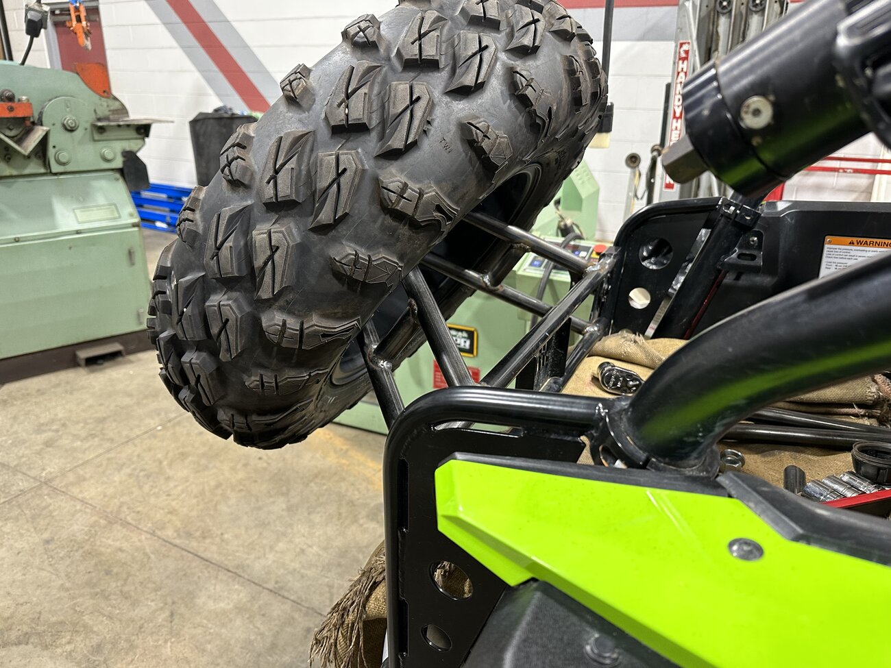

Having customer fab spare tire carriers for my Talons. I took him several photos and we discussed placement and function. Went by this afternoon to look at how things were coming. I have HMF rear tailgates for the cargo area. Here's what he came up with. Curious to hear thoughts regarding what we've done. This is still a work in progress. Once finished, I plan to powder coat. Waiting on wheel studs and lug nuts

Care to tell us why it's so far out from the tailgate? Thinking leverage, lever arm and other physics that come into play. Maybe thinking more rearward will help damp the Talon's known bucking issues?
@Scrappapotamus is planning on running rims with +250MM offset ... :)
First off, you work with the hand dealt when fabricating an existing component. The tubing on the HMF tailgate probably wouldn't have coped with the weight and continued pounding had we mounted the wheel/tire assembly parallel to the machine. Our mount's tubing was attached outboard closer to the existing uprights for strength. The bucking these machines are known for was a consideration, and tilting the wheel assembly should help with weight distribution on the gate and enhance rearward visibility. I shopped and purchased several mounts prior to going this route. HMF looks to have had one similar early on, but their's was mounted in the center of the gate between the upper and lower tubes and guessing why they aborted their design. I reached out to them but was stonewalled by the telephone attendant.
