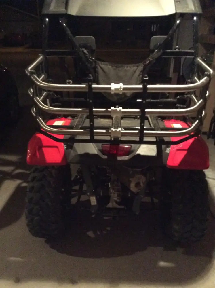

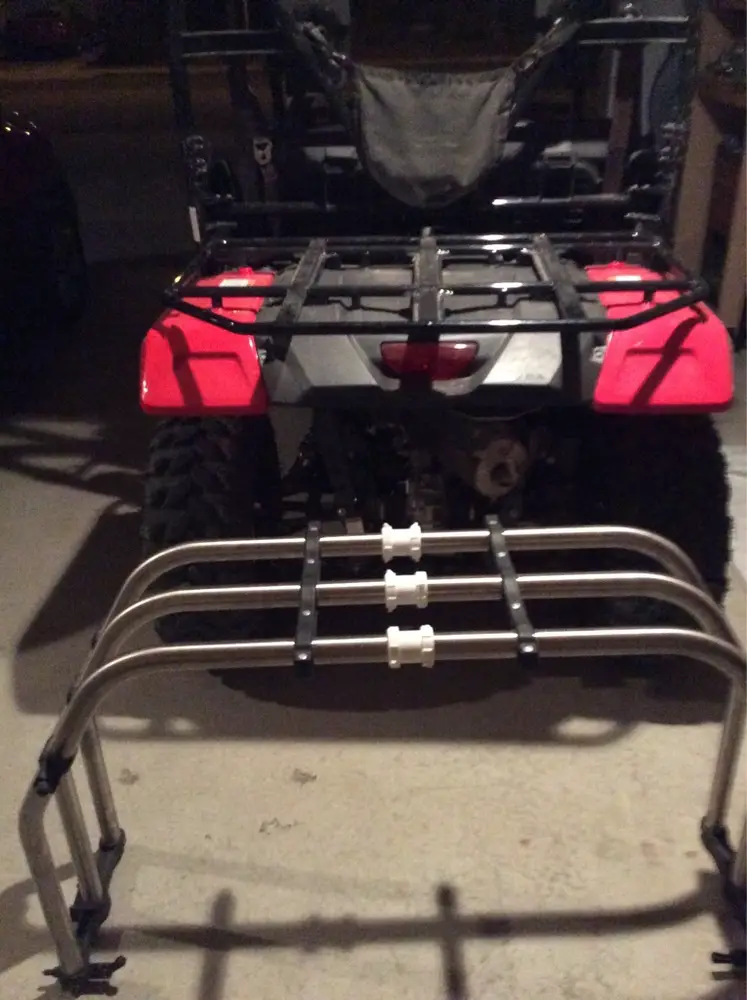

Took an F150 tail gate extender (free) and cut out 10 inches front the center section. Used compression fittings to hook halves together and just finished mounting it up to the roll cage. Hadn't seen this mod before so i thought I'd share it 9a5901f222d1c94c8863c7360af20358B2a4ea42ea08ff1df9b9e85bb202cd55

Took an F150 tail gate extender (free) and cut out 10 inches front the center section. Used compression fittings to hook halves together and just finished mounting it up to the roll cage. Hadn't seen this mod before so i thought I'd share itView attachment 25516View attachment 25517
Sent from my iPad using Tapatalk
Great thinking that's a nice mod.
Reactions: HUCK
39,129
Really cool idea!

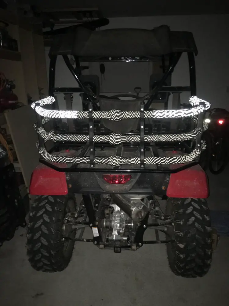

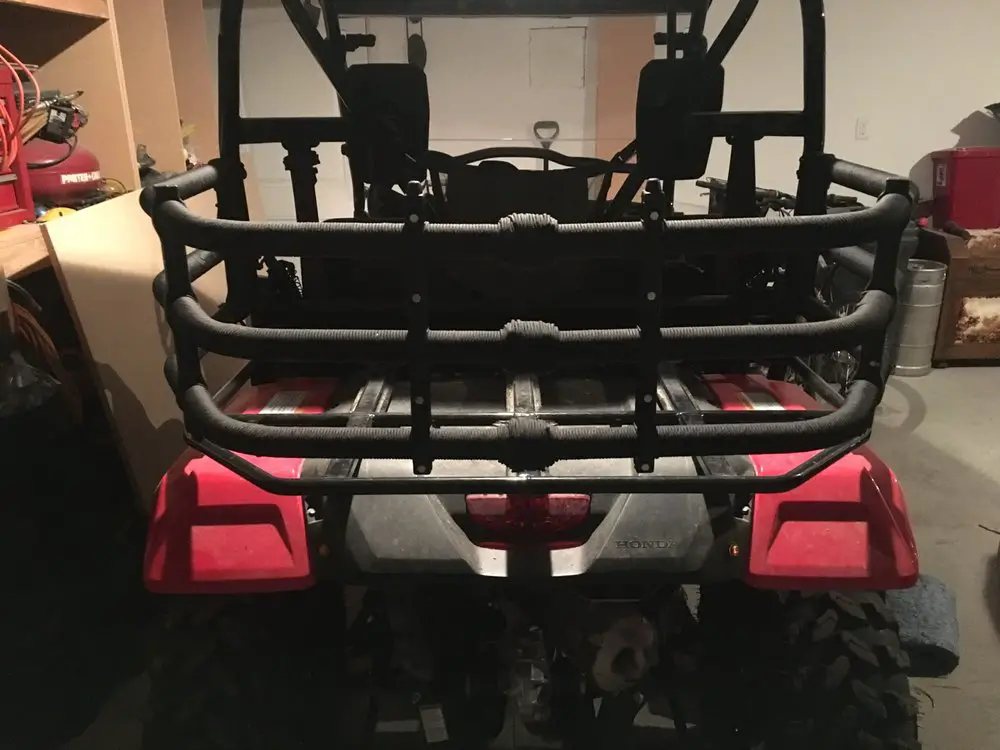

Didnt find any connectors I liked that would quick disconnect from the roll cage, or wouldn't mark it up. So I went with parachord and tied diagonal lashing (with slight modification due to end to end at 90 degree tie point). Fit is extremely tight and allows 1/4" up and down movement at the rear to allow for the plate i plan to mount on top of the storage rack. Then i'll wrap the rest of the extender in parachord as well. Can never have too much rope when its needed.

Finally got the extender all wrapped up in parachord. Used chord with reflector spots so I would be able to find my ride at night even if I cant find what I may have been hunting for.

Finally got the extender all wrapped up in parachord. Used chord with reflector spots so I would be able to find my ride at night even if I cant find what I may have been hunting for.View attachment 32531View attachment 32532
Wow, looks like wrapping that took some time? Looks cool as hell though. :cool:
