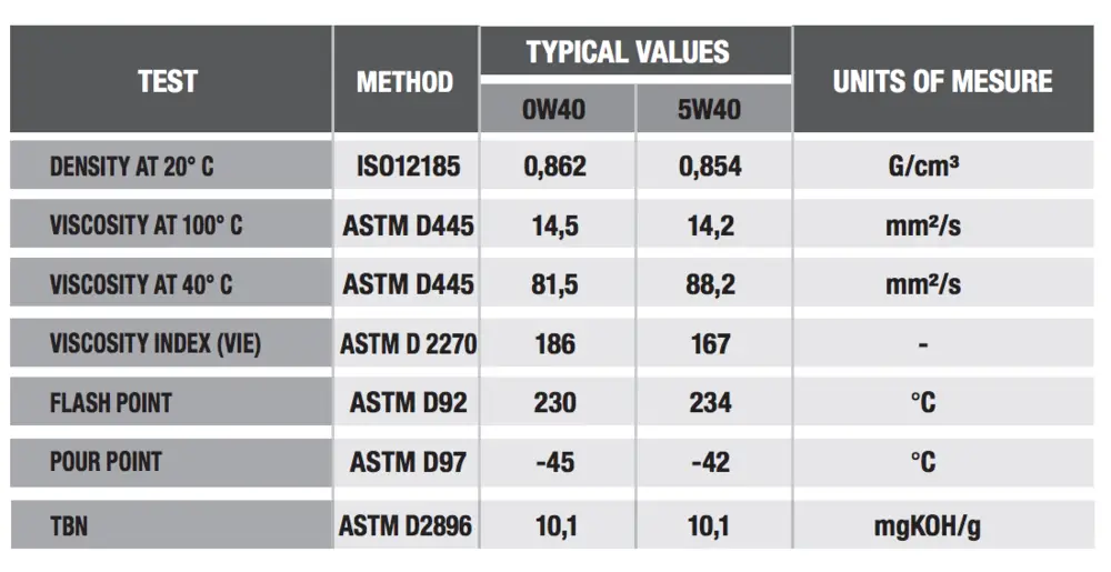

Thought I’d add some findings since playing around with the oil viscosities. To start, I had never had any of the slam nois before playing with different oils. I did the 100 mile service and put amsoil metric 10w40 in everything as I had it sitting around from my motorcycles. Not a single issue with the sub trans, no shift hesitation, gears went in smooth, no banging. i had the amsoil in for about 800 miles. I had ipone stroke 4 0w40 sitting around from a can am outlander I used to own that I thought I’d try. Immediately, the sub trans was a little harder to shift. I had to move the machine a little, so I parked it outside, when I went to put it away afterwards, I shifted to high, went to accelerate and it made a little bang. So I immediately drained that oil out, it did nothing well for a gear box application. When draining, it was extremely frothy, airated. Good thing i only did a slow drive around the yard, back to the garage.
Long story short, ipone stroke 4 0w40 is not a good weight for the sub trans, so far amsoil Metric 10w40 has been the best, it’s completely different, the smoothness and no banging. This is the specs for the stroke 4 0w40.

That is an Ester based oil and they are designed for higher temperature use and are notorious for foaming at lower temperatures.
Another concern with Ester oils is seal compatibility. Ester based oils can cause certain types of seals to swell and leak and may not be at all compatible with the seal material that Honda uses. Good thing you drained it quickly and you may want to keep an eye on the seals for a little while.

Thanks for the info about ester oils. I wonder if a lot of the difference with how smooth the trans operated had to do with it being an ester base or if it was because of it being 0w40.

Probably both. I ran 0W-20 full synthetic during the winter and it made a big difference. Back to 10W-30 for the summer and I can tell.
HondaBob also experimented with various oils and has determined that 10W-40 with Moly makes the Sub-Tran shift like butter. He says it made a HUGE difference. See this thread...
