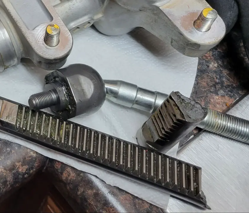

I went with the SATV Chromoly tie rods just because I couldn't swallow $500 for tie rods. That inner ball and socket bent hard in my little wreck. In the picture the ball is centered.
Maybe Weller will make them again one day and I can take the SATVs off for back ups. 727f082f3a248583db4a991723770ea9
Maybe Weller will make them again one day and I can take the SATVs off for back ups. View attachment 324579

Nope. Oem inners.
i kept them on purpose as a fuse even with my RB3 rack.
On the SATV kit I bought the inner-ends don't even look as beefy as the stock ones but the tie rods themselves look to be quite a bit stronger. The inner-ends are the weak point in either case and I tend to think you're right that having that inner end bend may prevent damage to the RB3 rack. However, when my factory rack was destroyed the inner-end was also bent about 45° as shown above.
Reactions: Buggyman

The stock inner tie rods are junk just like the rest of the stock tie rod. Thinking it's going to be a fuse is a good assumption as it's probably going to be the first think to break and leave you stranded. I crashed the f*** out of my car last season and managed to break the front diff in half and chip a tooth on my RB3 rack. You know what didn't break and leave me stranded? My ZRP full replacement tie rods or the RB3 rack. Because the RB3 rack combined with the ZRP tie rods is such a bullet proof combo I was able to pull the front diff apart and race the feature in 2wd because my steering "fuse" didn't put me out for the day.
To each their own, but thinking that replacing just the outer portion of the tie rod makes it "better" is just wasting money on a wish.
