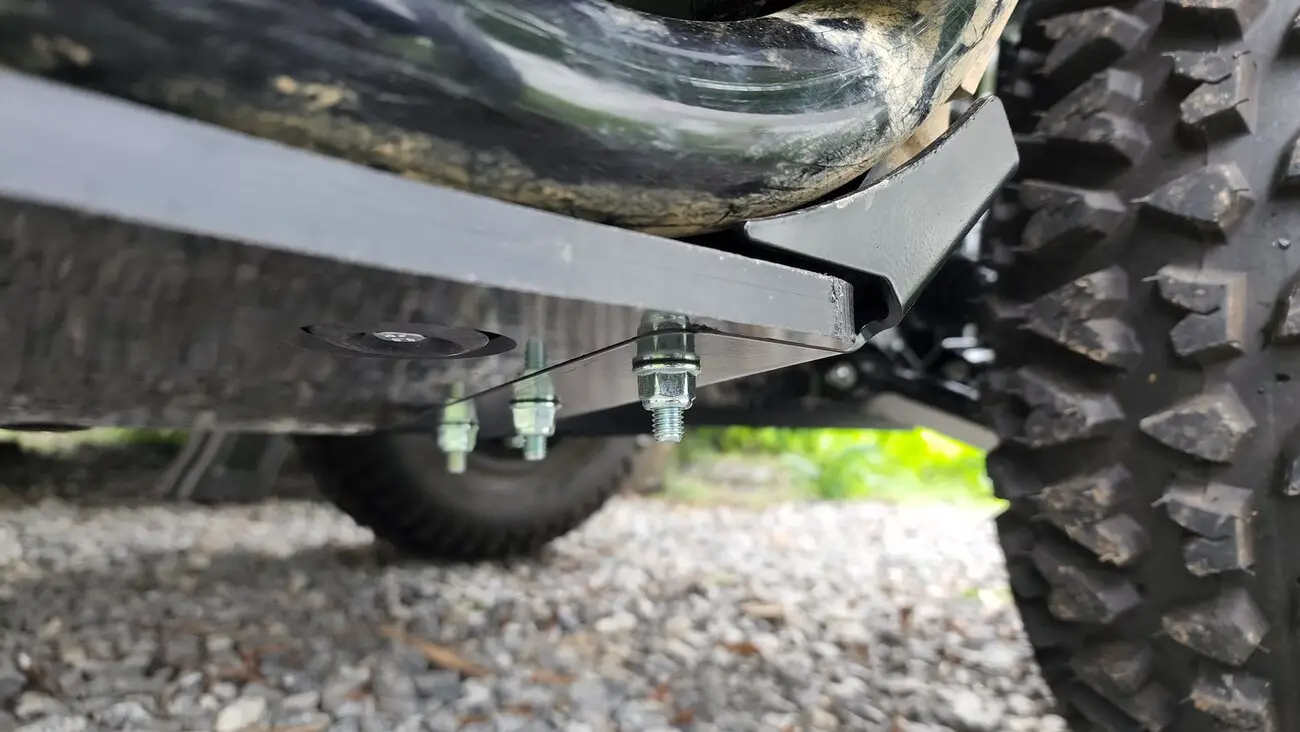

  1. 520
Careful on superatv skid plate, If you follow their online instructions you will get this IMO unacceptable outcome... 6 @ 3/4+ protruding Inbox 4 521 waynester58 gmail com Gmail20220507 103005 resized20220507 103023 resized20220507 103126 resizedspikes, problem for many reasons

Careful on superatv skid plate, If you follow their online instructions you will get this IMO unacceptable outcome... 6 @ 3/4+ protruding View attachment 333128View attachment 333130spikes, problem for many reasons
Definitely an issue… Nearly lost one of mine at TO. To be fair this is the result of taking a very hard drop on a rock ledge. However sticking out as they do makes them vonorable to damage and ultimately failure.
Also gave the skid plate a nasty scrape on a rock at about 7 or 8 mph, hit very almost caused me a dead stop. The stock skid would have ripped open like a paper bag. So I will give the SuperATV skid .. 2 thumbs up. Price is right.. Just remember if you are ordering for P500 .. you will need to slightly modify it.
Thanks @KYgal83 !
The shop that installed his skid definitely put the button bolts in from the top...upside down.

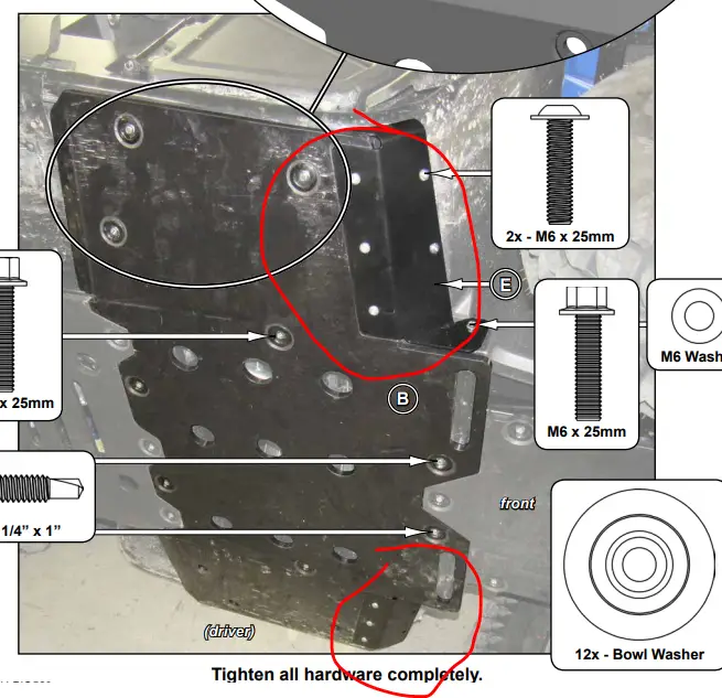

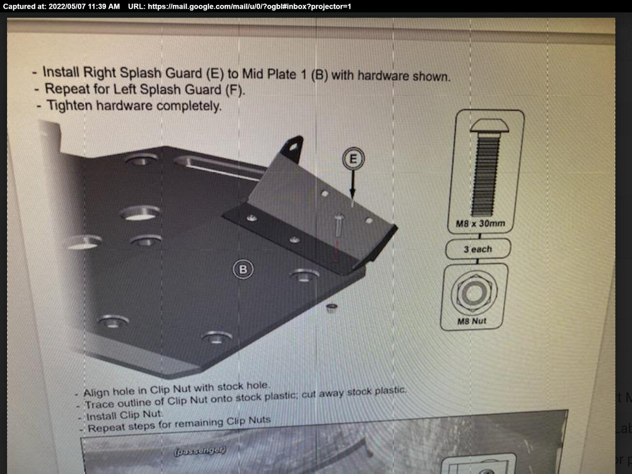

Installed my bolts the same way.. from the top. I felt like they were incorrect… but I followed the instructions that came with my skid plate.. and it calls for them to be installed in this way.
Yep, I'll see if my guy that makes the instructions can figure out a different way to show that image.
Something in the model is incorrect on that view.
The other views in the manual are correct. I definitely see where an inexperienced assembler would follow direction over experience.
You are exactly correct. I am inexperienced and followed the directions as provided.
