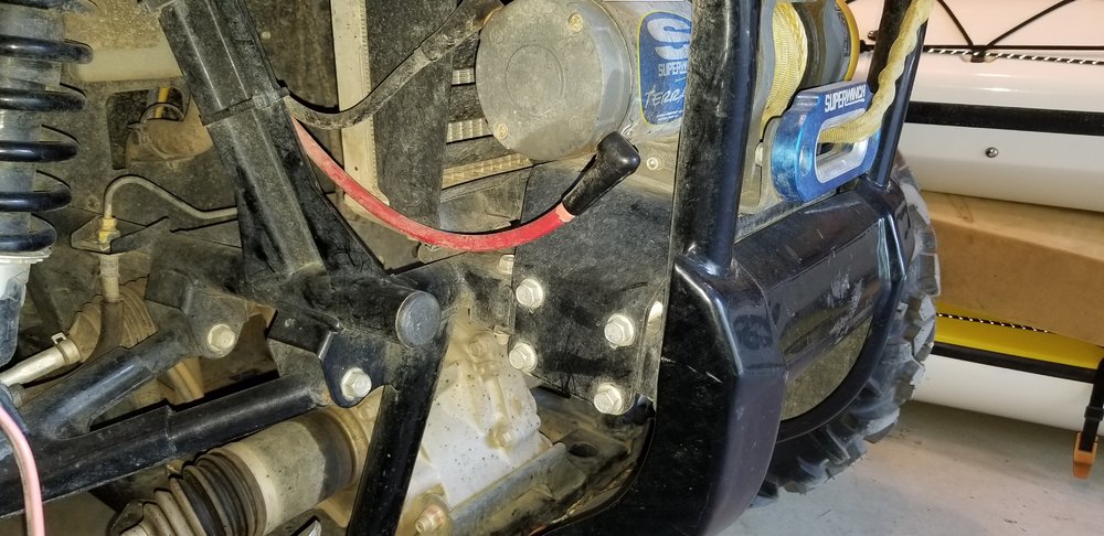

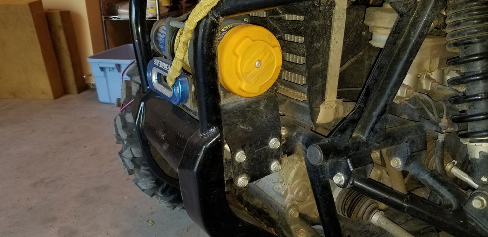

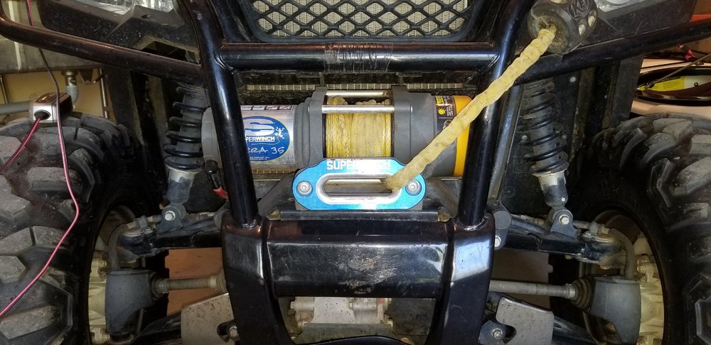

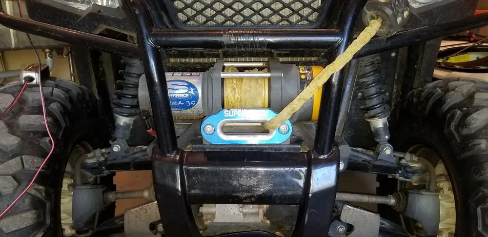

I have a KFI mounting plate on a Honda bumper. I wanted it high to keep it out of the water. I have a wireless remote as well. $18 its handy.
15358310622536459498102893902304
15358311382827228079300400401217
Hope this assists. I think we'll have the same set-up.

Thanks for the pics. Looks good. That’s exsctly how I want to mount whatever winch I end up getting. And that’s the superwinch A3500 on there? Looks like a terra series? Also when you wired that up did you use the accessory sub harness from Honda? I’m planning to use it when I wire mine up. Thanks!

Get the synthetic rope without fail. I used the Honda harness to power the relay but ran a heavy guage wire direct from the battery back to the winch. I also power my lights off of it.

Yeah I’ll defin use that sub harness. Is that a terra series winch you have on there now?

Yes. Superwinch Terra 3500SR. All you need. But just in case i have 2 snatch blocks. Never needed them.

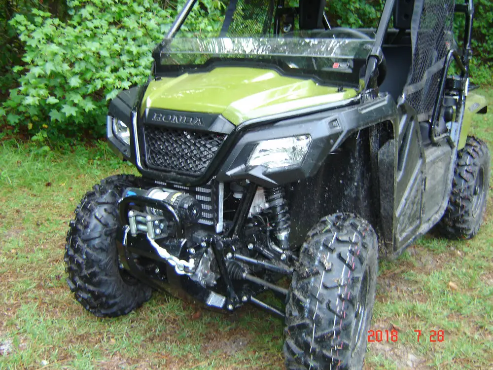

What type of synthetic rope did you put on your A3500?
If I get the Superwinch A3500 I’d need synthetic rope and a wireless remote to complete the deal. And I’m going to run it in a KFI mount which is 50 bucks give or take. Decisions decisions[/QUOTE]It is made by Superwinch,best I can tell.I'm still using wire rope on the A3500,but ran syn. rope purchased from e-bay on a 2500lb Traveler winch mounted on a Honda Foreman.It held up well.This is the A3500 on the KFI mount on my P-5.It's a well built piece.Compare it to the 3500 Traveler while in Tractor Supply and the difference is clear.

It is made by Superwinch,best I can tell.I'm still using wire rope on the A3500,but ran syn. rope purchased from e-bay on a 2500lb Traveler winch mounted on a Honda Foreman.It held up well.This is the A3500 on the KFI mount on my P-5.It's a well built piece.Compare it to the 3500 Traveler while in Tractor Supply and the difference is clear.[/QUOTE]
Thanks for that pic. That very well maybe what I end up putting on mine exactly what you have pictured there. It makes since. It’s in my price range and is a major name brand being superwinch (assuming the A3500 is actually made by superwinch in house). Only other things I’ll need with this winch is a synthetic rope preferable in orange just think orange will look good in there with my olive color. Having trouble finding 13/64 orange rope though. Assume you need the same size rope as the wire? And I’d add me a wireless remote. I think it’d look and work real good whenever I get the Honda oem front bumper as well. Thanks again for that pic and your help
