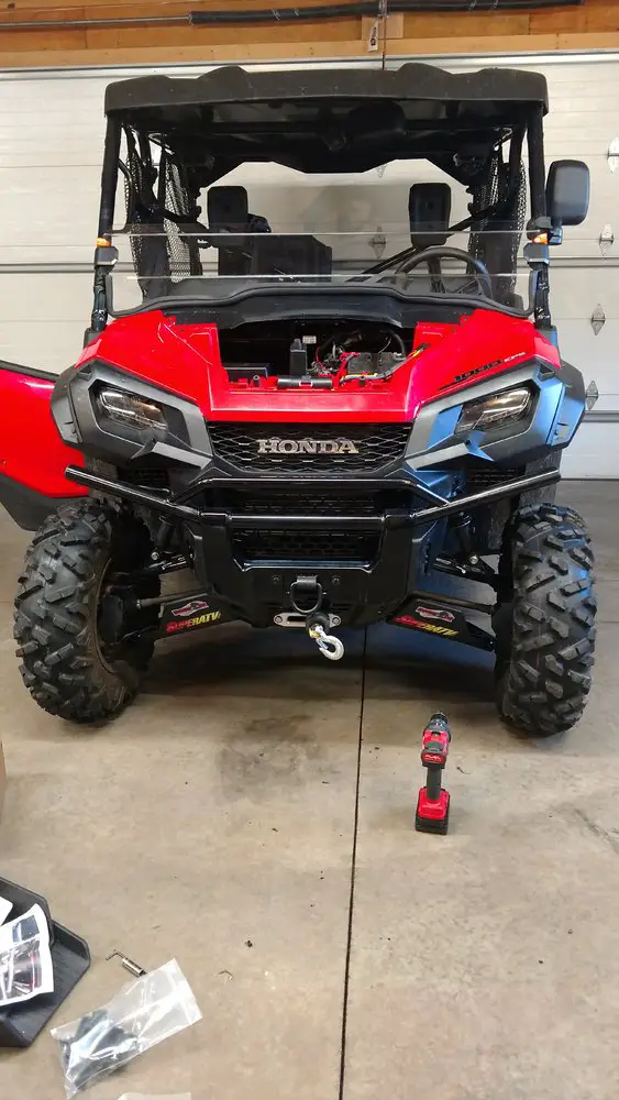

Good looking clean install. I like the terra series have it on my sportsman and will add one the P5, only issue I ever had with my Superwinch was the free spool knob, seems like it always gets jammed up with mud or dust and became difficult or impossible to turn.

Great looking setup, that shackle looks like a great anchor point for a snatch block. What shackle did you use and how did you mount the fair lead?
It's a 12k 1/2" weld on d-ring.

Like this
Lashing Rings - Weld On 1/2" x 12,000 Lbs Forged Lashing Ring
