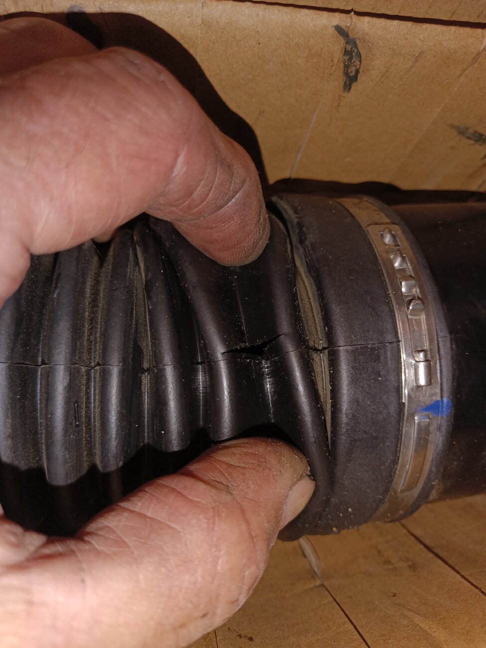

Wonder if anyone has found a good rear axle that will hold up to running hard. First off I have tried many different ones. The Honda ones are the best but now they do not offer new rear in side CV replacements. Plus they stopped the front in side axle seal as well. Have three sets of Rhino 2.0. they do not last and a joke to try and get replaced when you have any problem. One was bad out of the box and SATV wanted 160.00 to replace. The snap ring inside comes loose and ends up in the CV area. Open Country last a little longer but still for only 3 to4 hundred miles. Monster lasted 10 miles on a flat dirt road and the inside boot split. Demon Xtreme HD went 75 miles and the boot split, and they are 400.$$ each.
I am doing open desert racing. Run limit straps that stop 3" before topping out. Have the Fox 3.0 one the rear. Now with stock Honda out has anyone found one that holds up to the extreme desert racing. Thank you to all.
