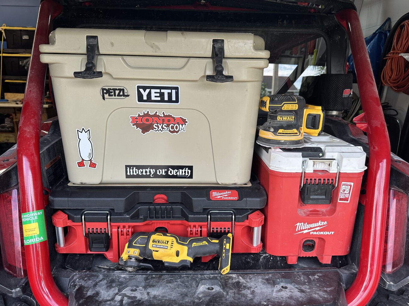

I have been looking for a ready made solution to mounting a yeti cooler on a Packout base for some time without luck so I decided to come up with something on my own.
I found a Packout work top for $50 odd bucks so I figured what the hell. Well it wasn’t as plug and play as I’d hoped.
IMG 8094
Jankyeye
Jankyeye
Dec 17, 2021
883
4,191
Tampa, Fl.
However, I have a few tools laying around so I decided to hack on it a bit. After some careful measurements I made my first cut only to find I’d cut the wrong corner. :rolleyes:
But after a few more measurements, cuts and a little sanding I managed to make it work.
And that my friends is how the yellow tools made the red tool useful.

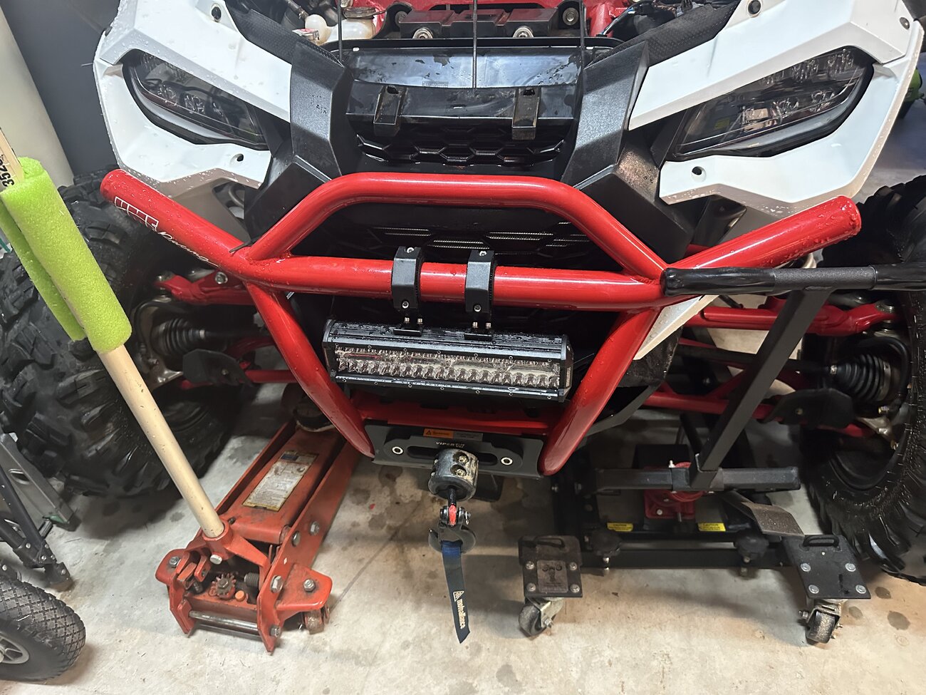

Wife ran through a soupy mud hole last trip and lost all headlights (just coated them). Just happened to be a night ride and she panicked a bit. So I picked up a light from the club store. Had to get longer screws to make it work with the HMF bumper but it looks clean. Honestly I doubt this would have helped her at all in that instance so I’ll probably add some cubes or another light bar across the roof.
IMG 8257
Mudwisel
Mudwisel
Nov 23, 2020
10,162
83,946
Tampa Bay Florida
I am sure the mud hole she decided to play in during the day didn't help much

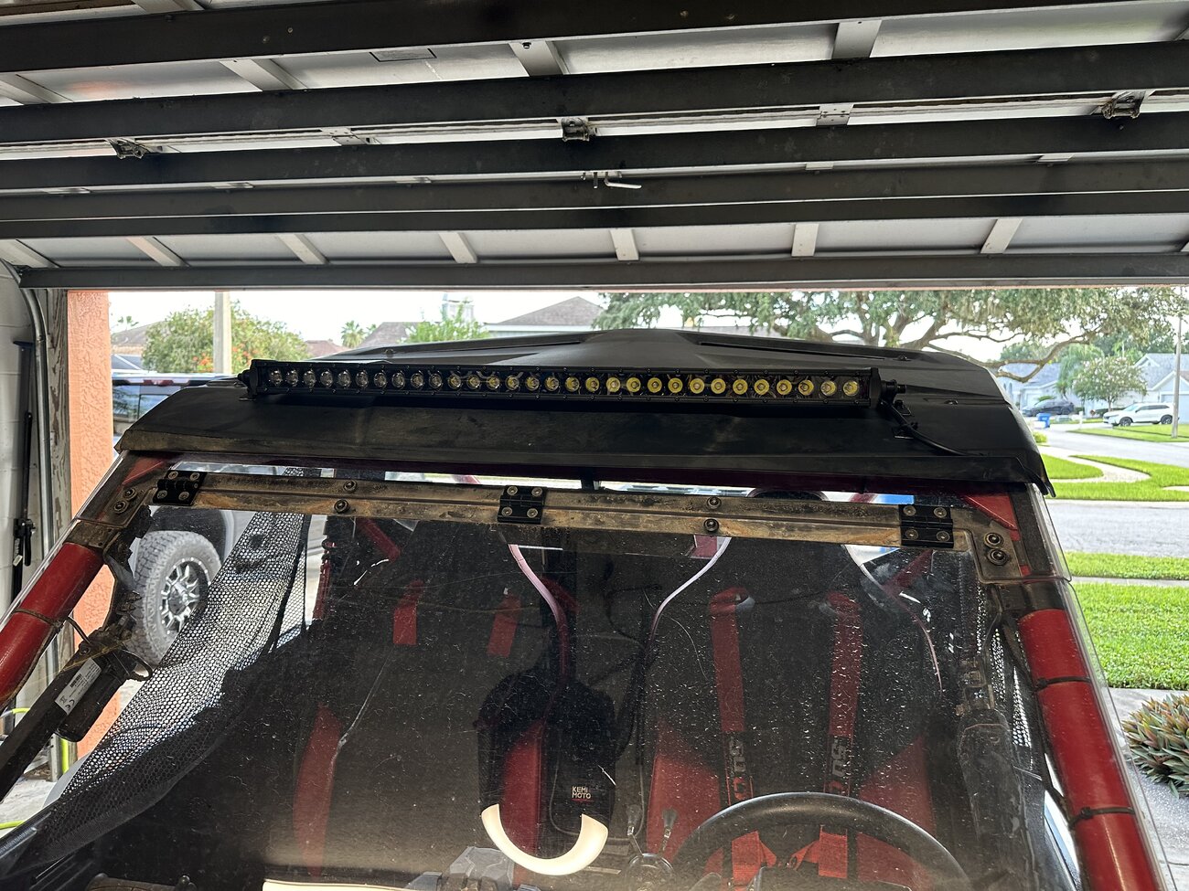

Next time I'm around my rig I'll get you some pictures of the route I took for my light bar. Check out my profile pic. You can barely notice it up in there. I should be able to explain the process as it was really easy. On the front of the factory roof, on the drip edge, get some stainless washers and bend them curved so they fit down in the valley. Buy a curved 24-30" slim light bar to hang underneath. Buy high beam activated plug from club store. Go buy cheap black extension cord. Wire light to headlight plug wires.
Stays out the way of limbs also really sleek. You could go wider... Anything bigger/larger will make the roof unhappy and would be overkill IMO.
Jankyeye
Jankyeye
Dec 17, 2021
883
4,191
Tampa, Fl.
Thanks Brett, thats along the lines i was thinking. doubt it gets much use but it will be there if needed.

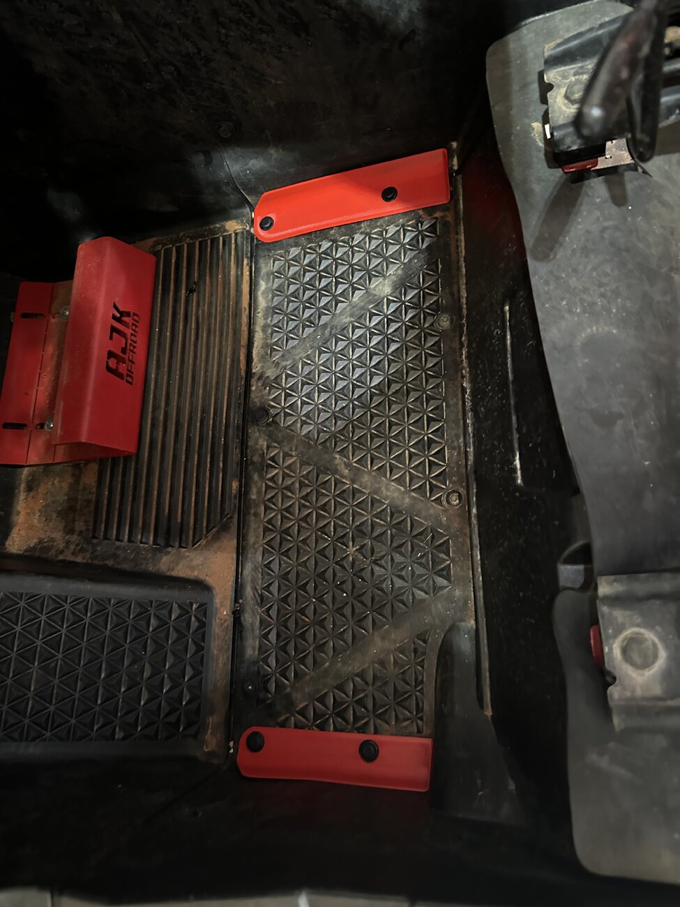

I noticed the floor boards filled with water much quicker than in the P1K. Suppose it’s the great big holes in the floor board. So I thought I’d try the covers from 10-80 Dirt Sports. Install was easy and I guess we will see if they help or just hold the water longer.
IMG 8263
Scoop
Scoop
Sep 7, 2021
5,421
21,321
  3. Talon R LV
They drain water just fine, but if you get a bunch of dirt/mud in there, you'll want to pop them out, rinse it all out, then put them back in. Otherwise, that mud will never flush out.
