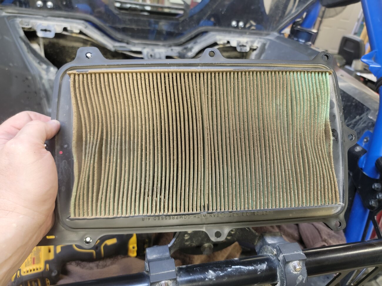

I installed my 10-80 pre-filter kit 8 days after i picked up the Talon, maybe a dozen or two miles on it.
432 miles later, I just pulled the OEM filter. There was definitely a fair amount of VERY fine dust/dirt behind the OEM filter. The OEM filter itself was pretty coated, too. Nothing had made it through the OEM filter, as the other side was clean as a whistle. I didn't expect to see that much inside the airbox, though. Then again, I've only had the Talon for less than 1 year.
How often do you all clean your prefilter and how do you clean it?

I just used compressed air to blow it out from the inside.

I reached out to @highpocket74 on my situation. Turns out I don't know a damn thing about how to properly maintain this pre-filter setup, and my expectations of a dry filter were unrealistic.
Basically, this is all on me. In my defense, I've only used oiled filters in the past. Completely different than dry reusable filters.
Now that I have that information and background on the Desertcraft filters, I'll be following a more rigorous routine, both in the field maintenance and for full-on cleaning.
I did order a couple new OEM filters, but will probably blow this one out and see what it looks like. Not sure if the instructions molded into the filter about NOT blowing it out with compressed air are for any reason other than Homds convincing people to buy more filters.

No clue why there is an interest to clean a filter that is uncleanable.
It’s your engine - there is a reason it states that and it’s not about selling a $40 filter.
Honda knows a thing or 2 about engines and filtration - maybe they don’t know so much about the intake placement on the talon. It only takes a small hole unseen to the naked eye in a paper filter from compressed air cleaning to let the fine dust be injested by the air pump.
Good luck.

You do you.
There could be a small unseen hole in a brand new filter, too.
In case you missed it, I did order two new filters.

Cleaning air filters with compressed air is a major know no. We deal with this often in our shop where someone has attempted to jump a buck resulting in complete engine failure. Only way to overcome a dusted engine is spending $$

I wouldn’t blow out an oiled filter, not sure how effective that would be.
I did find this how to clean desert craft prefilter video. Guess I will be washing them from now on.
