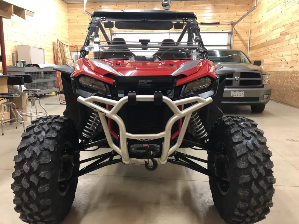

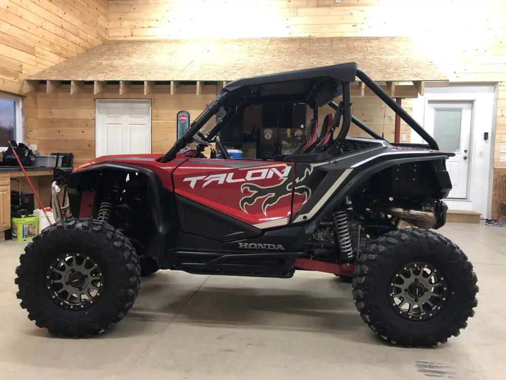

I just put SuperATV on mine and mounted brake lines how I thought I was supposed to. I overstretched brake lines causing to leak and my power steering seems weak with 32s. I am going to switch tires back to stock and see if its more the tires or the forward offset that affected the power steering. Then likely switch back to stock arms to see if that makes a difference in steering. I don't have an answer, but I have a feeling I will end up with stock upper and L&W lower. I'll update when I have a better idea.

That is kind of what I was afraid of. How much did the forward a arms affect your turning radius on your X? With hearing of a lot of guys running 32's with no power steering problem, it makes me think it would be something with the forward a arms.

I did not drive enough after change to know if steering radius was affected. Brake lines limited anyway.
