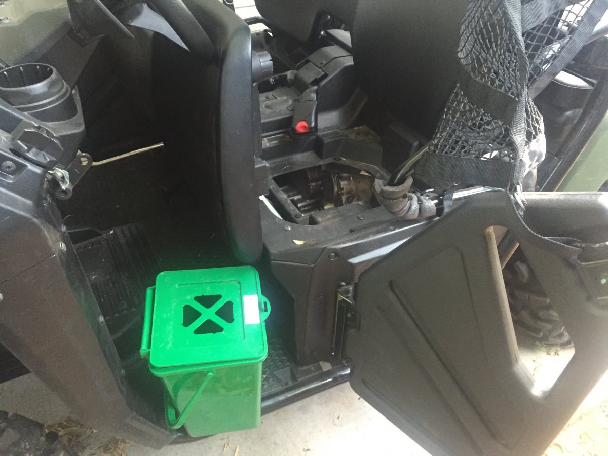

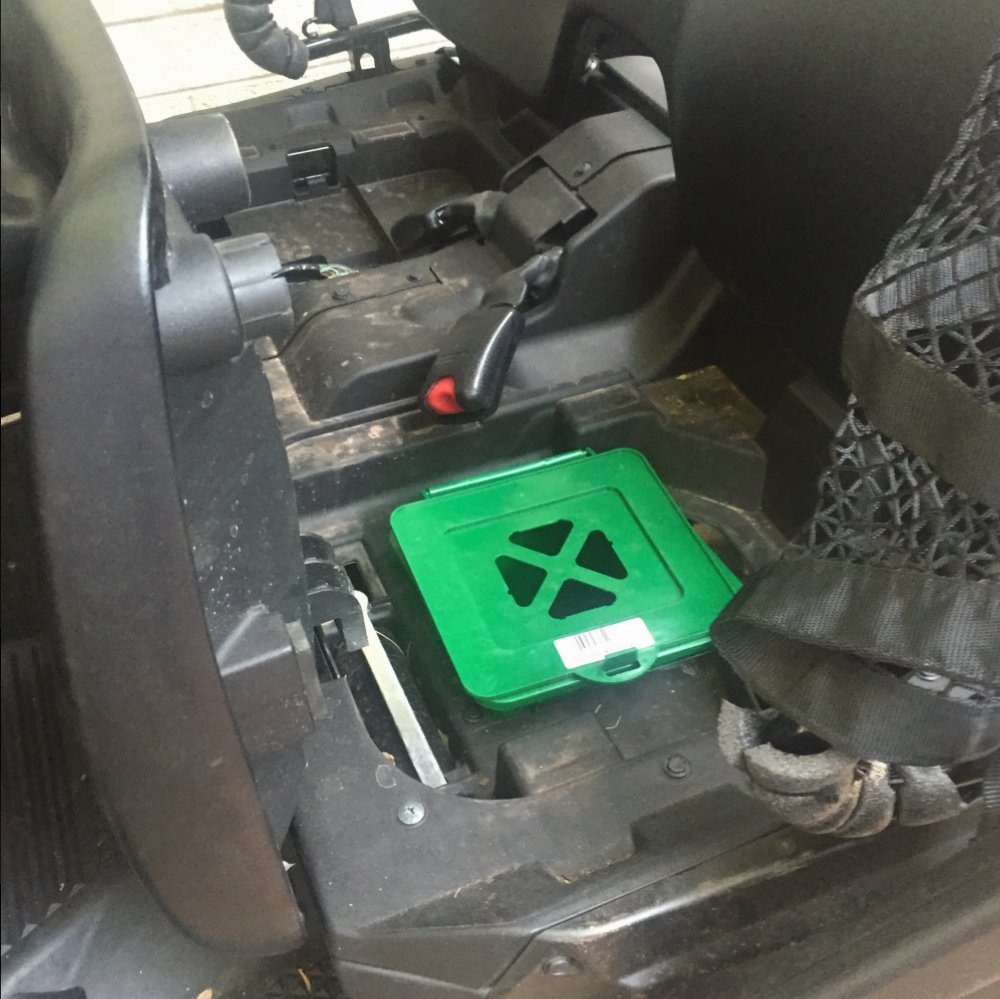

Is there any storage space under the passenger seat?

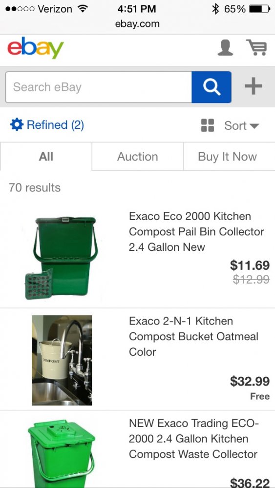

I am using one I found on a different thread here.This is a great find! Any similarly inexpensive options for under the hood?

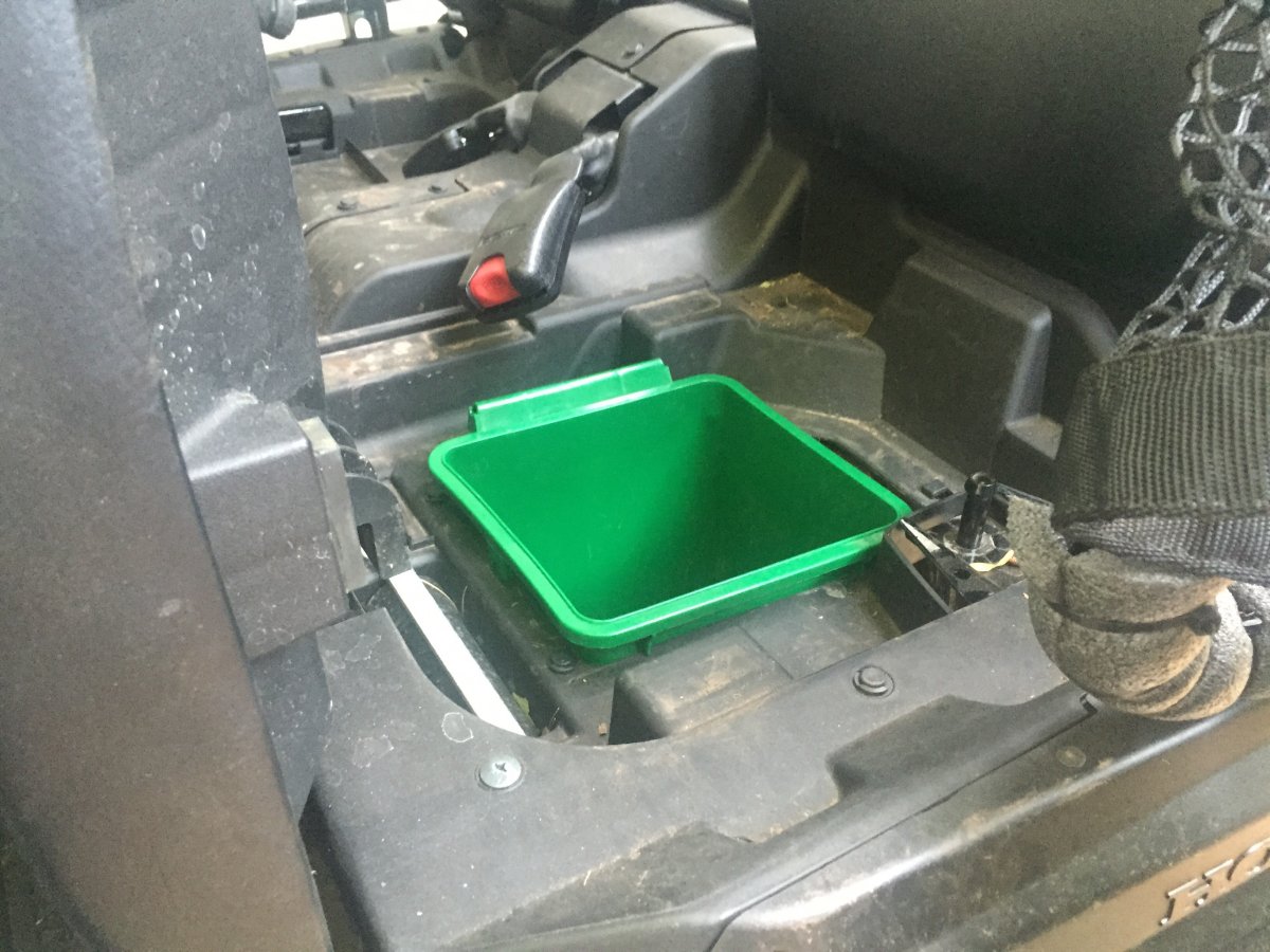

I'm just curious as to how it's holding up. Are you still using it ?Under seat storage idea worked. View attachment 6081
NextView attachment 6082

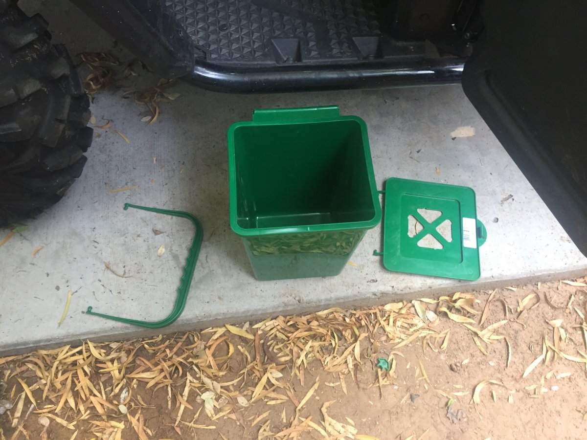

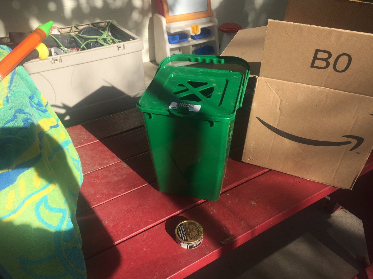

NextView attachment 6083
...View attachment 6086
...View attachment 6087
...View attachment 6088

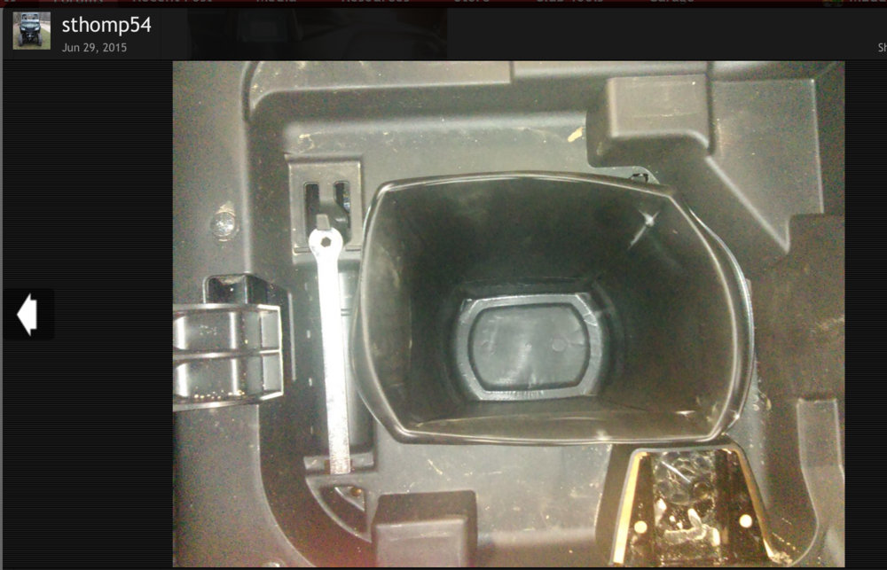

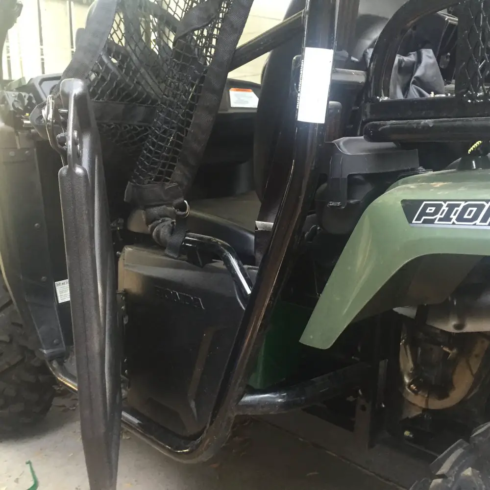

LIke a glove. View attachment 6089 View attachment 6084

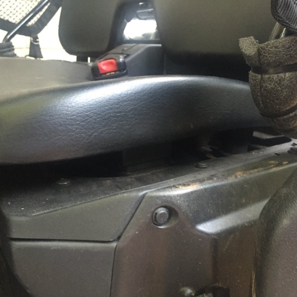

Agree on the brake line rub, good comment. I used a heat gun to deform the bottom of the plastic can to clear it, and to make the odd hole curve fit better. Didn’t take much heat, maybe a hair dryer would also work. Carry extra winch line/snatch block, and water jug for radiator wash out in there. Thanks to whoever came up with that can idea.LISTEN UP!!!
When using the $3.00 Wally World can under the driver's seat OR similar...
cut a 6" long piece of pool noodle -split lengthwise through one side over the brake lines/block or the can will rest on the brake stuff and eventually wear a hole in something or crack a line. If you don't believe me, look under there after your first ride with stuff in the can and you will see it touching. On this one I did NOT learn the hard way but I could have. LOL. I carry a small compressor and other things in mine. DO IT!!! You're Welcome.
