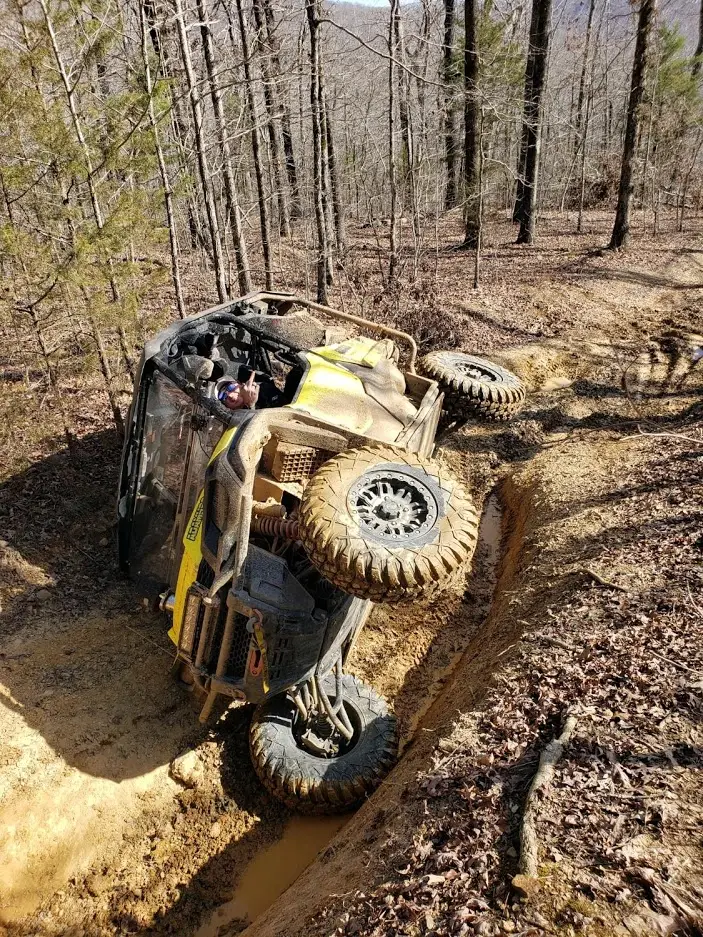

Welcome to the club. Sometimes they get tired and need a nap. Is your machine throwing any codes? There's an oil level sensor that will cut the machine off once it passes a certain angle to prevent engine damage, but once upright they fire right back up. Did you flop it over into mud/water by chance?

Hello all! Im new to the site and was looking to see if anyone has tipped their pioneer on its side and had issues with the machine bogging down afterwards at just over a quarter throttle. I read a few posts about the muffler having issues. So either I rattled the muffler hard enough to cause the issue or im having a different issue. Any help would be great as im a first time pioneer owner and still learning the insides of the machine thanks in advance!
WELCOME from NW Arkansas! I flopped ours once, that makes your flop look like nothing, ROPS where headed down hill. I did experience the same thing, checked the air filter and it was completely saturated with oil, doesn't take much oil to do that. So I would check the filter?
