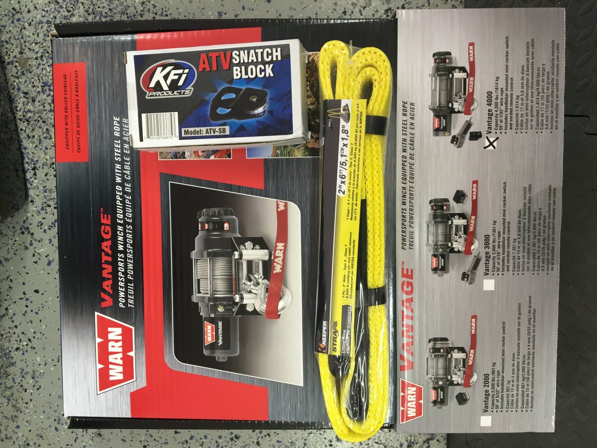

Ordered! Now the excitement begins..Pics are forthcoming.
*Warn LT4000, wide roller fair lead and dash rocker switch included
*KFI Snatch block
*KFI Winch Mount
*50 feet of 1/4 inch grey synthetic winch rope (6400 lbs) with 5 feet of end protection
*6-foot tree saver
*KFI rubber Winch line stopper

UPDATE. I installed the first plate of the KFI mount, opened the box, and took out the winch. WARN SENT THE WRONG WINCH! ArrrHHH. The box is labeled right, but it included a Vantage 3000 winch, not Vantage 4000. Can you believe it!?
Nooooooooo! Man that's a bummer. Hope their customer service works smoothly for you.
PioneerPete
PioneerPete
Jan 3, 2016
1,496
3,516
Chattanooga, TN
UPS picked up the wrong winch at 830pm last night, and brought the correct winch this morning. That's pretty darn fast!
