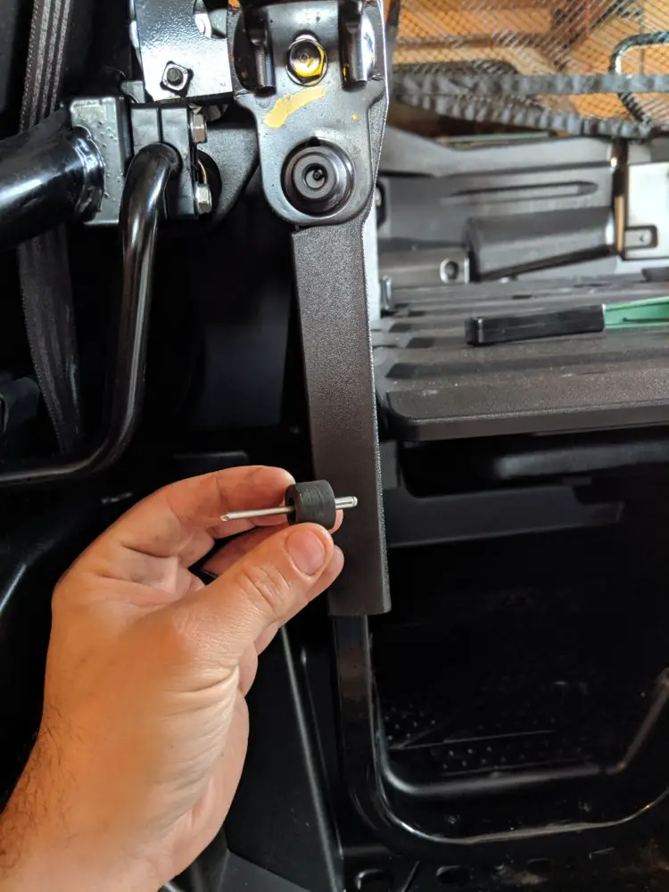

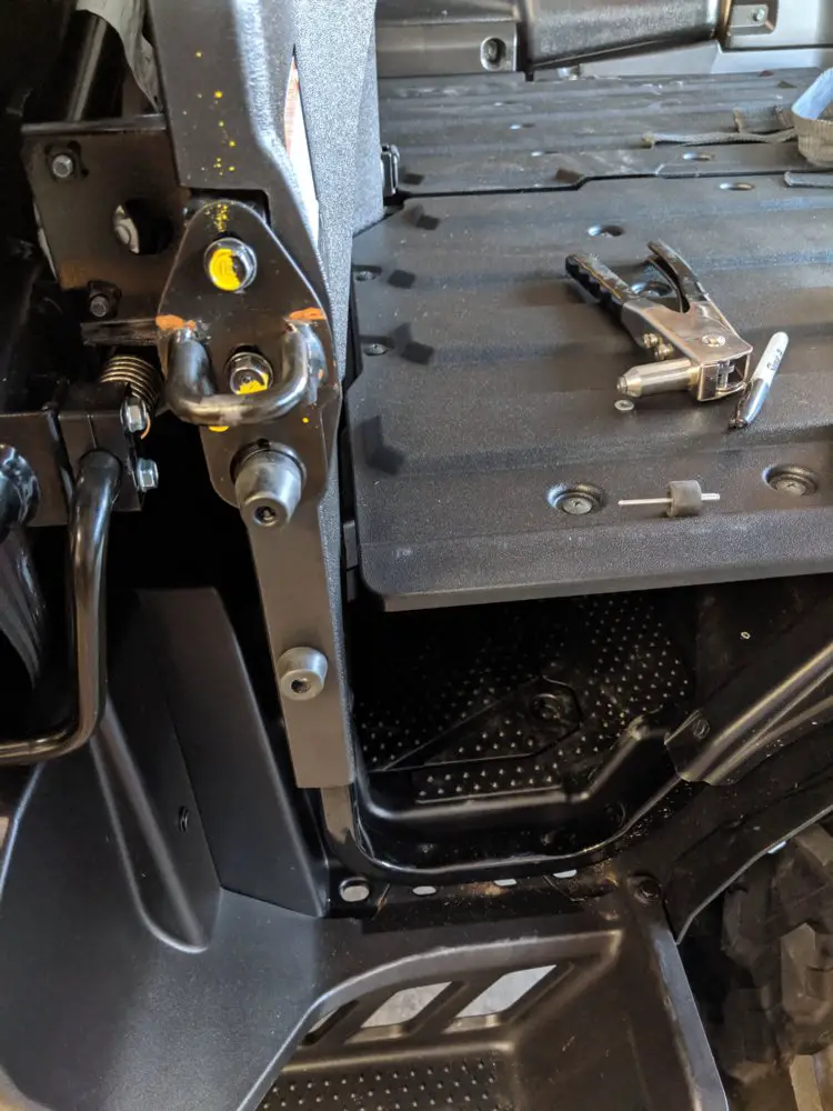

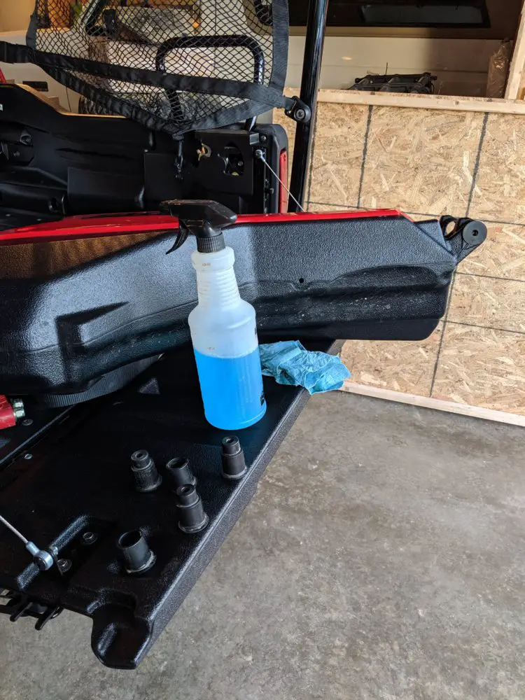

Made some progress today. Added RB3 door bushings to the rear doors and a second rubber door bumper.
The bumper is 4" below the stock bumper and 1/2" tall. 1 rivet to install and a backer washer to keep it in place. It definitely reduces the slop around the door latch

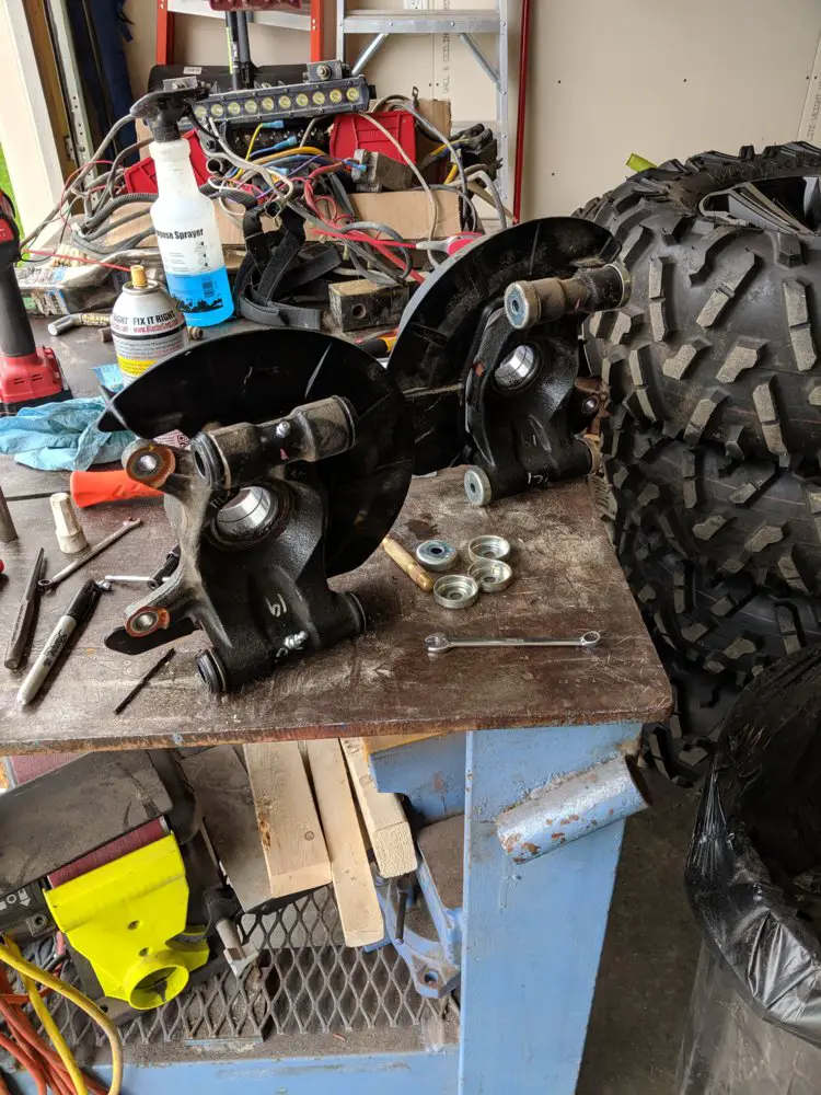

Drilled and tapped the rear knuckles for grease zerks

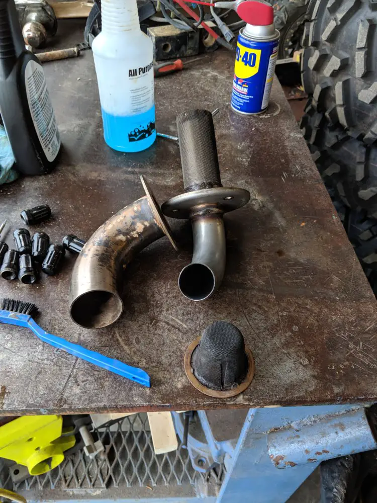

Exhaust tip and spark arrestor replaced

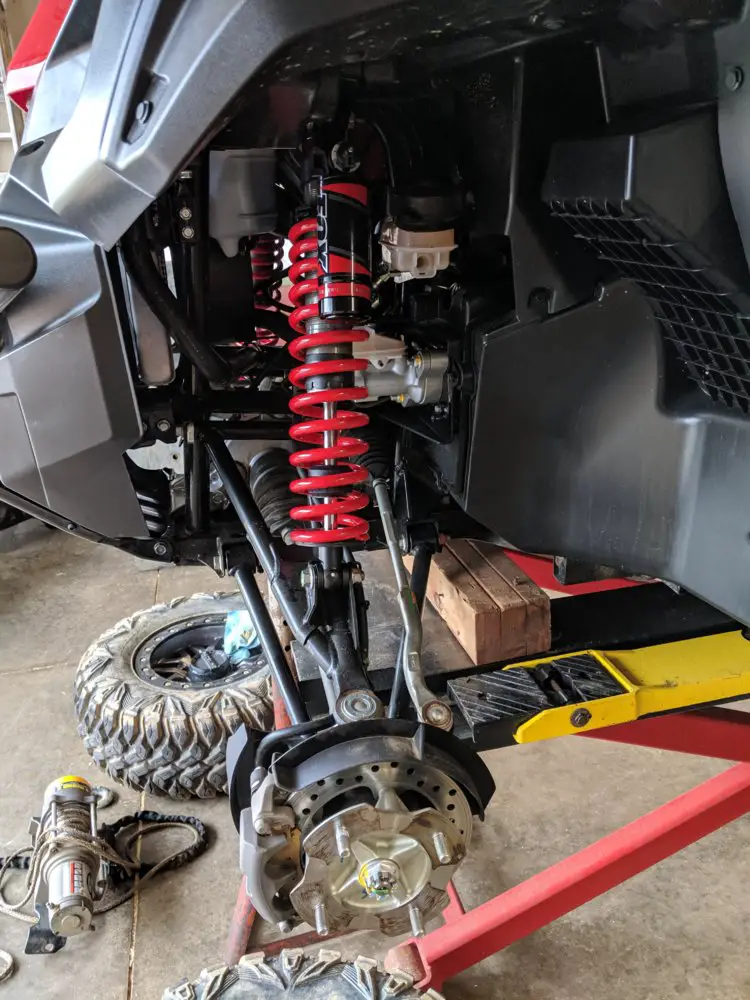

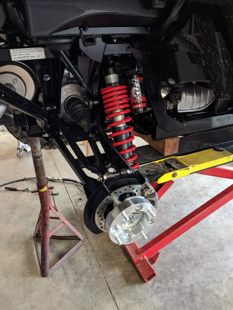

Pulled the rear sway bar, added wheel spacers. Installed Fox Shocks
IMG 20190524 162325
Installed front Fox Shocks
IMG 20190524 171145

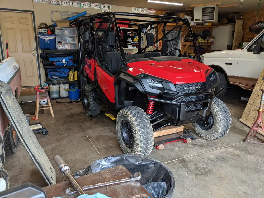

Back on all 4s.
