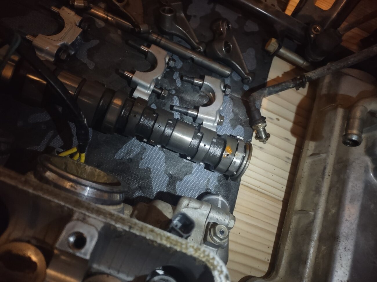

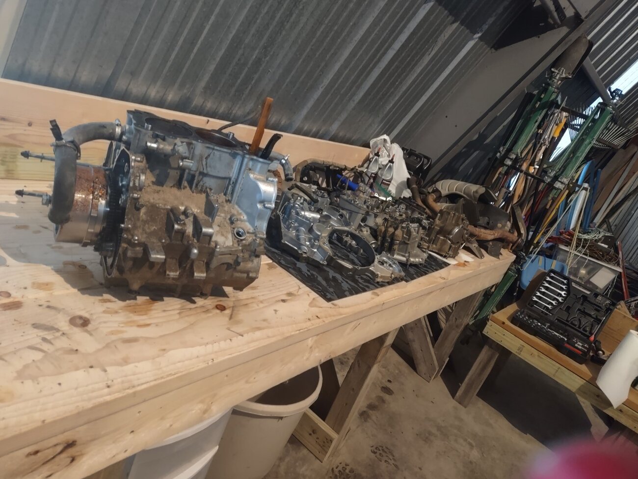

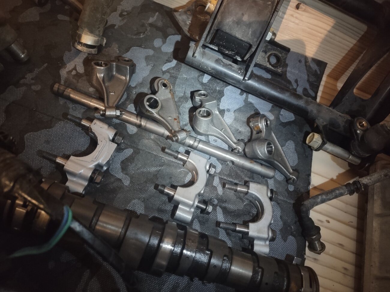

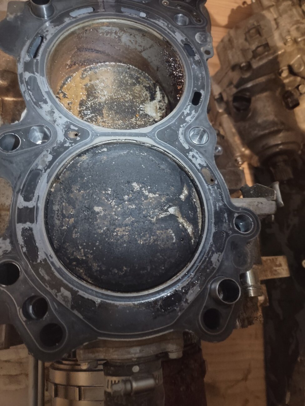

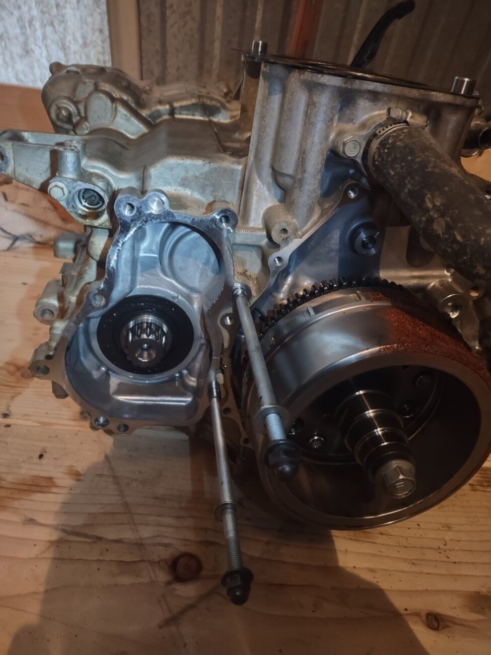

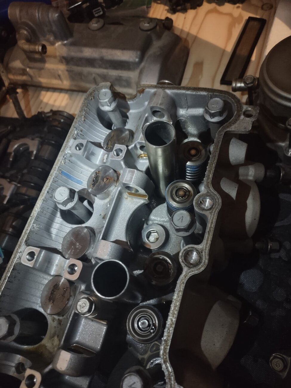

Hi,
New to the forum. I bought a 2016 P1000M5 for cheap of an auction. It was flooded. Finally got to tearing it apart. There was definitely water in the oil and one of the valves was still holding water, etc. My thoughts were to tear down the motor completely to give it a good cleaning as I don't know what was done to it before. The engine will NOT turn over. I was able to loosen the flywheel bolt without holding the flywheel, however, I think this is mainly due to the pistons being a bit rusted in the cylinders. I was going to try to get something to loosen that up today. I don't think it was ever ran after it was flooded, which in my view is good, but still alot of water in it.
Questions I have as I do this:
  1. For those that have torn it completely down, are there any Honda Specialty tools that you needed outside of normal shop tools? If so which, so I can get them coming.
    1. Specifically I think I may need to rotor puller (07733-0020001) and something whatever is needed to rebuild the head.
  2. Where do you take the casing and head to get machined, cleaned and inspected? A dealer or a machine shop? I think I am going to have to have my cylinders at least honed well to clean them up.
I have the engine mostly torn down and hope to finish today and start ordering parts. I am thinking about replacing most of the bearings in it then just cleaning the rust of the iron components that rusted and reassembling.
Any other tips for a complete engine teardown from those that have done it?
Here are pics of some of the components that have rust.

good luck in the rebuild - awesome.
for 2\4 stroke mc engines - I just sent the cylinders out to a reputable shop (KOR, Millennium, LA Sleeve, etc.) and had sleeved\nickasiled\resleeved whatever - some dealers can do it by my experience is they are slow and expensive for the same freaking service or they just send it out and charge you a mark up for doing nothing - so research a little
case halves for that thing are $1800 new and may be a an option as well depending on how deep that corrosion has pitted the cylinder to be cleaned up - I am guessing piston to cylinder clearance is .003-.004" (001"/1" piston diameter )
atf\marvel mystery oil and patience will be your friend for the piston removal - lol, good luck
