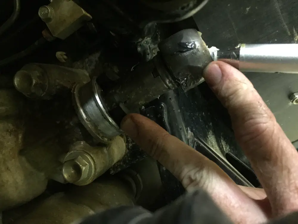

Those look the same except for color. They just pop on, no need to in-bolt anything. You will have to cut the metal band on the inside of the boots though. I used some heavy duty zip ties about a thousand miles ago and they haven't leaked any water yet. If you know me, that's saying something. CP says I'm like a duck, either flying or swimming.
I used some axle grease where the boot seals under the zip tie. Also, I filled the boot about half way with grease just incase.
I forgot about you having extra lift, you may not want to shave the stops any.
Here's a pic of the nut you want to put a wrench on make sure it's tight. Both of mine were a little loose and causing some slop in the steering. My other finger is pointing at the "stop" that is popped in place.
That is good to hear. I really didn't want to have to pull the tie rods and have to replace that locking washer they use. I think I was able to reuse the old clamps the 1st time I had to straighten my tie rod. I ended up buying the 3 different type of clamp tools. Just looked at the clamps, shouldn't be a problem reusing those.
