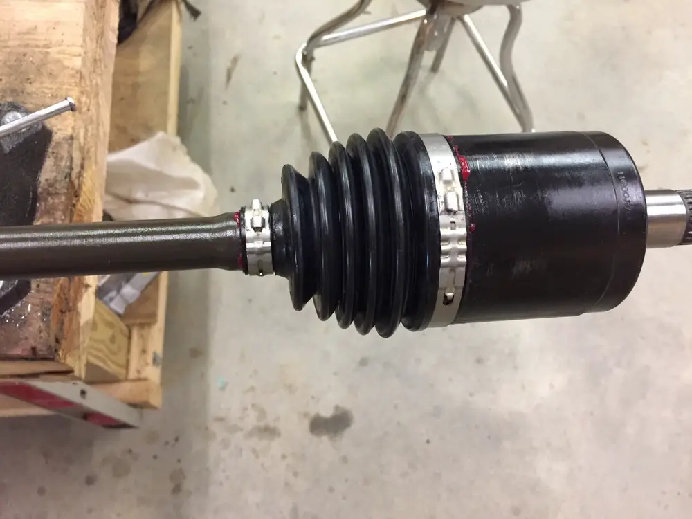

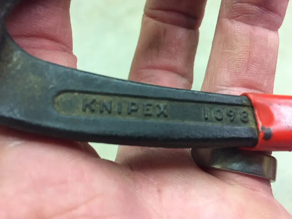

Are those just slip joints or special clamp pliers?
We used to use them for water lines but I've used them for garden hoses, transmission cooler lines, etc. you can get the tool and an assortment of clamps for a reasonable price.

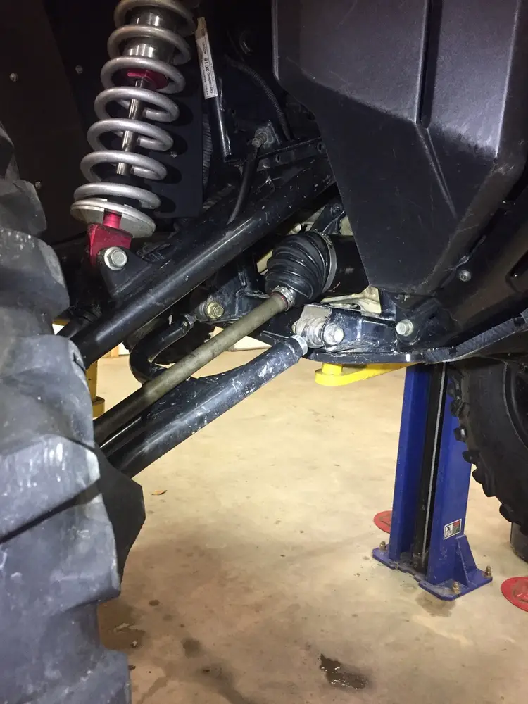

I believe I will keep using stock axles because if I upgrade the axle strength, the next thing to break could be the differential.
Smart man
Manwell
Manwell
Jul 12, 2016
803
2,439
I agree with this logic 100%... Working in the world of industrial gearboxes, I'm positive that the failure mode will show-up somewhere else. Weak links are a good thing, especially when they are easily accessible and relatively inexpensive!
