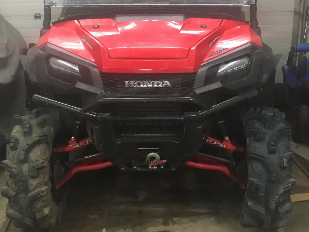

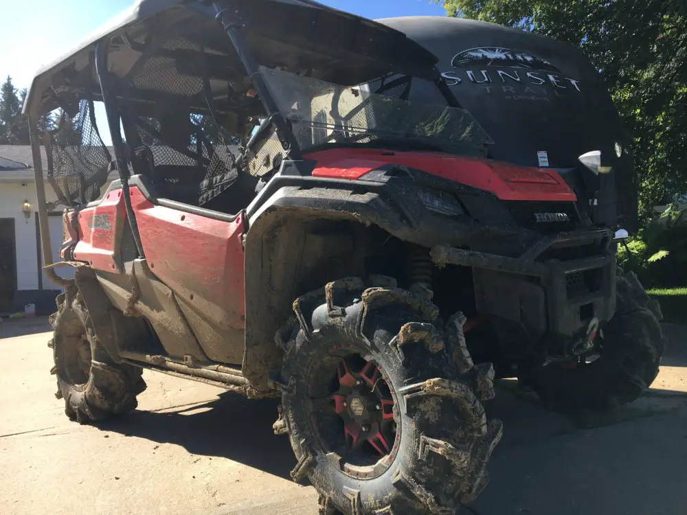

30” AMS Mud Evel’s no lift just HL Arched forward arms. No rubbing at all.
