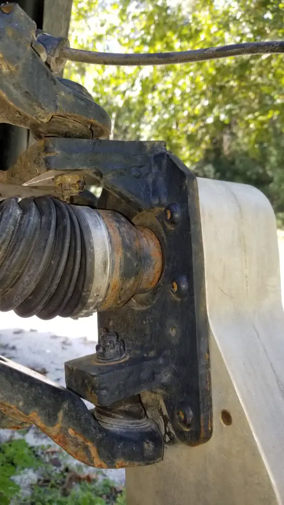

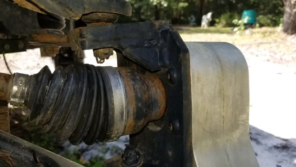

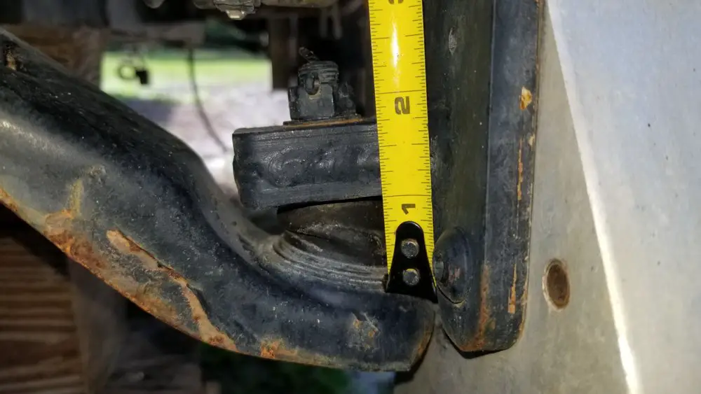

Dont know if these pics will help you. These are portals that are meant for a 700 that I put on my 500 a while back. It looks like they double stacked plate to make them about 3/4" where the balljoints go through. The backing plate that the portal box bolts to is 3/8" plate. I will actually be taking them off this weekend and going back to 30s with no portals. Ordered 31" Motohavocs for the wifes and when they come in Im taking the 30s off hers and putting them on mine. These are UTVsolutions 6" portals, which Im sure are different than yours, but maybe the pics will help being there is no one around you for you to look at their portals. If you need anymore pics or measurements let me know.
View attachment 162897 View attachment 162899 View attachment 162901 View attachment 162904
thats essentially what im going to do to mine
