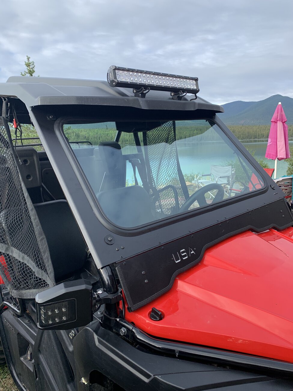

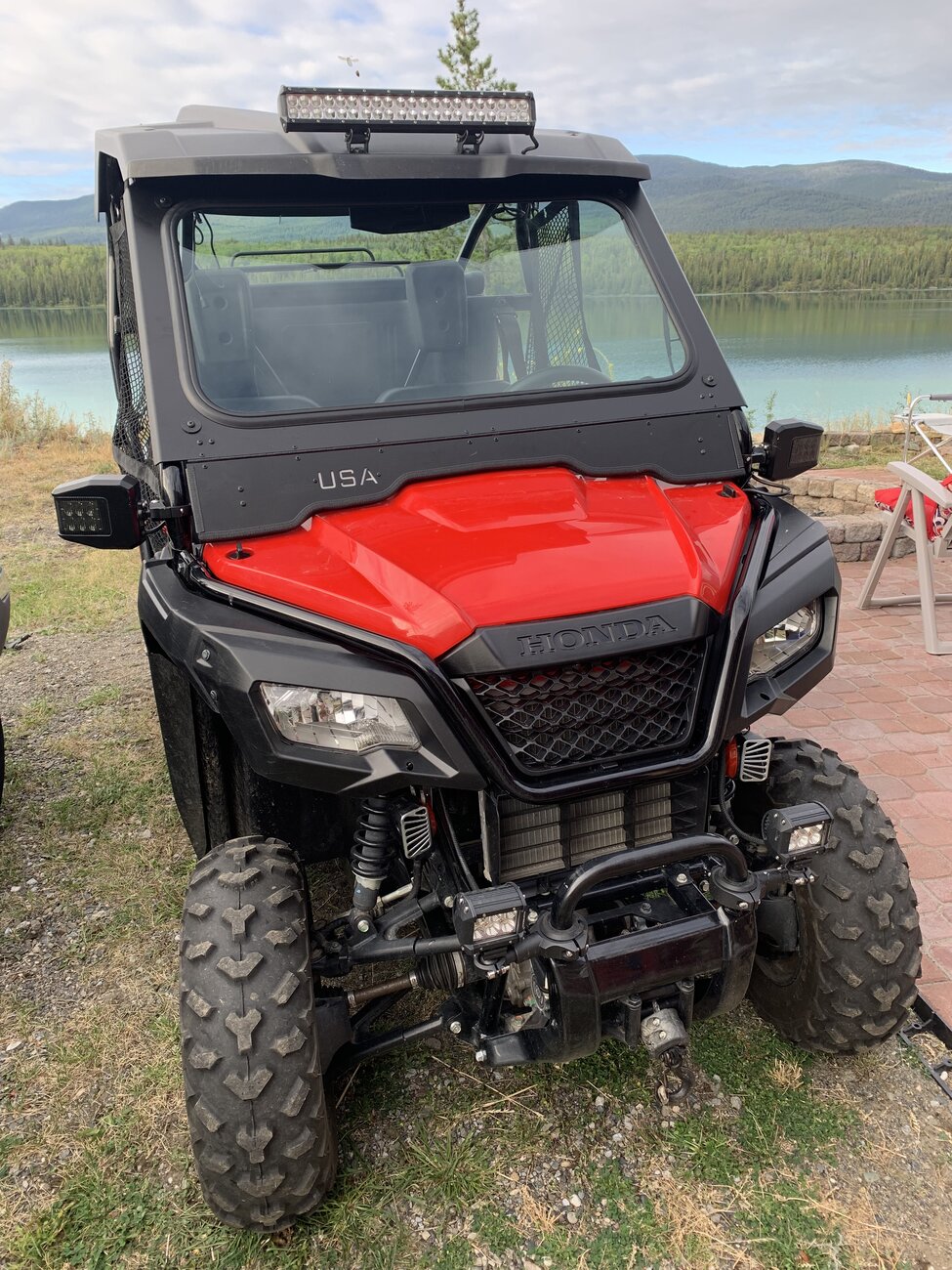

Hey Welcome,
I went with the UTV 801 glass, installed a 12volt wiper from a 2006 Ford Escape rear wiper.
The bottom flips up for venting also provides the needed clearance to open the hood. Installed a section of waterline foam insulation to fill the gap at the top of the windshield.
I also tossed between the flip up super atv , the turning point for me was glass is much harder to scratch versus poly windshield I’m very happy with the quality of the 801.

View attachment 368804 View attachment 368805 View attachment 368806
The key is YOU LIKE IT . hope the wife does .. LOL /, Looks great

a related question, that light bar. is it simply secured to the plastic roof? or does that bracket go through to a metal bar? could you send me or post some inside pics of that set up? roof/windshield look great...wish I had a wiper.
