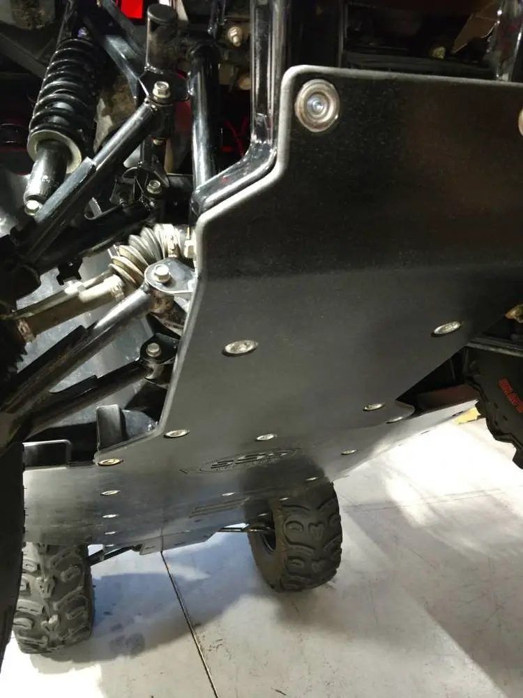

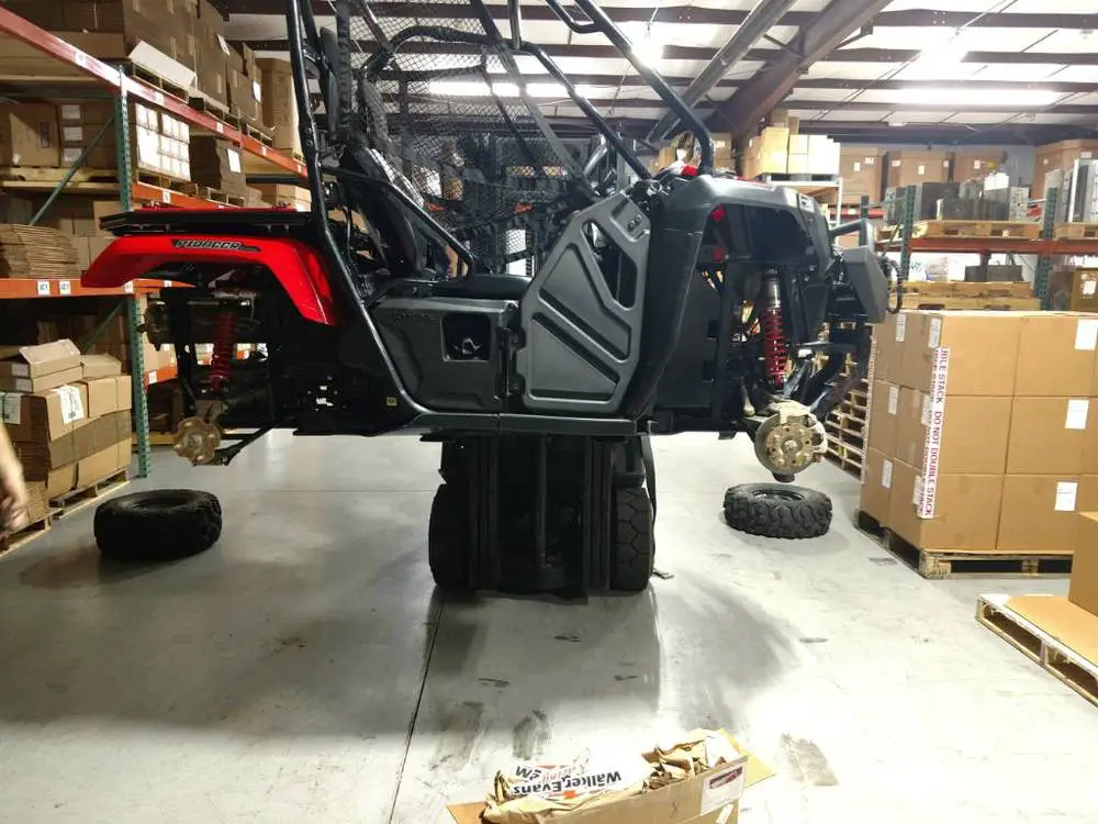

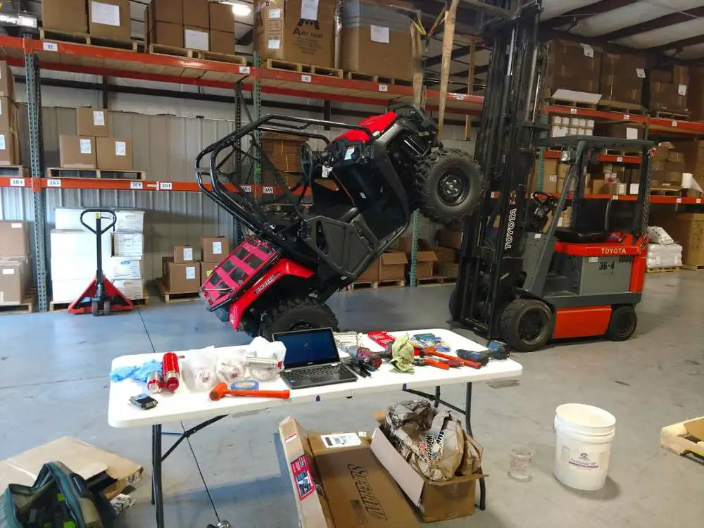

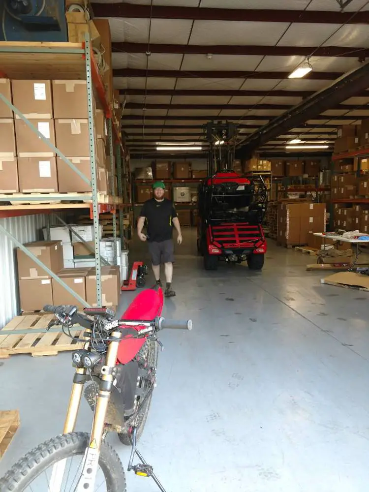

Finally got time to get the shocks and everything else installed. Shock installation was pretty simple thanks to a buddy and his forklift. The SSS skids we're a little more difficult but not too bad. I will say that I was a little disappointed in how the Skids came out. When we lined it all up, the driver's side rocker guard had about a 3/4 inch gap while the passenger side had to flex a bit. All the holes lined up properly but I'm a bit OCD when it comes to stuff like that. I did try to center it on my own but then the holes that needed to be tapped didn't line up right. Oh well, right? Now I want to ride

My skid was the same way. It’s tough though.

Fit lose and have a rubber mallet and a few beers, HA!
