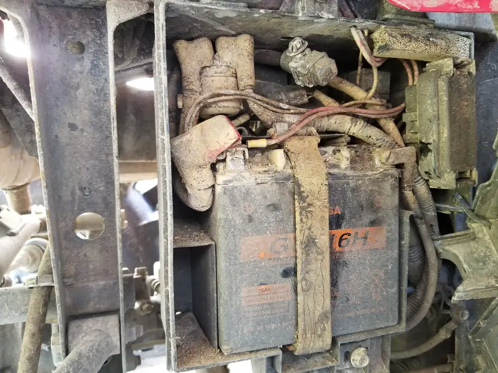

Yes sir! There is probably 3 people world wide that hasn't had problems with the battery box cover. I swore i would relocate my battery, and all the other electrical goodies that are in that box, but i havent yet. I am in the process of rebuilding my rear diff today so i'll share a pic of the inside of my 2016 P5 battery box with you. Its a little dirty. Dont judge! Lol

Here is my ghettofabulous fix for the box. On the forward side of the box I put zipties slightly loose through the lid and through the edge of the box. Lets call this a ghettofabulous 'hinge'. The rear side of the box has zipties through it in the same fashion. I cut the rear ties to get in the box if needed and just re zip with new ties after. Its a totally sucky way to do it, but it works lol.

Thanks for the picture and information as now I can see inside. I have been trying to get the bolts out without success. It is like some kind of nut on the back side. If I could just hold them, maybe the bolts will come out. I figured it was the battery box because I noticed a voltage regulator with cooling fins on the outside of the box.
