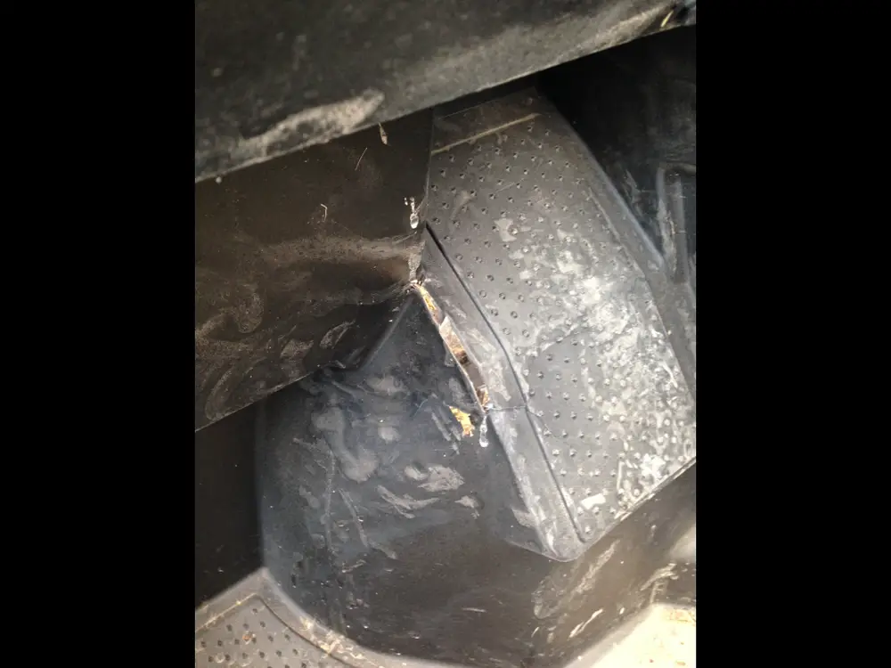

@joeymt33 bolted some 1/4 uhmw plates to that area.
I have full skid plates but they would not stop that stick. Or other similar punctures I have seen pictures of. Man, someone is gonna hurt!
I'll be doing the joey fix now. But I'm not sure if this stick would have been stopped or just redirected more towards the driver.
Skids wouldn't have helped stop this at all. It went right on the inside edge of the square hole piece. There is a kind small gap between the squares and the inner wheel.
The piece that Joey is holding wouldn't have stopped this either unless that piece is a little wider that the square section. You can't see it in the picks but it went just to the inside of the squares. I'll try to get a better pic of the hole location tomorrow.
39,129
The piece I'm holding may not have stopped it. But one of the other two would have. I put three pieces to cover the whole area. If I can help in anyway if you decide to add protection, let me know.

Ok, for some reason I wasn't seeing all of Joeys pics. In the complete pic, the piece close to the brake resvoir would have stopped this stick. On joeys inside pic, the stick came thru right at the inside edge of the three screws on the foot rest, missing the little squares.
Thanks for the pics Joey, I will be doing this mod as soon as I can get the materials and the replacement wheel well.

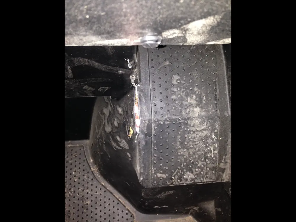

These should give you a better idea as to where it went thru the wheel well.

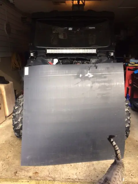

I got a 4x4 to work with.
This 1/8" uhmw will definitely be easier to work with than the 1/4". Will probably use bolts or maybe rivets.
