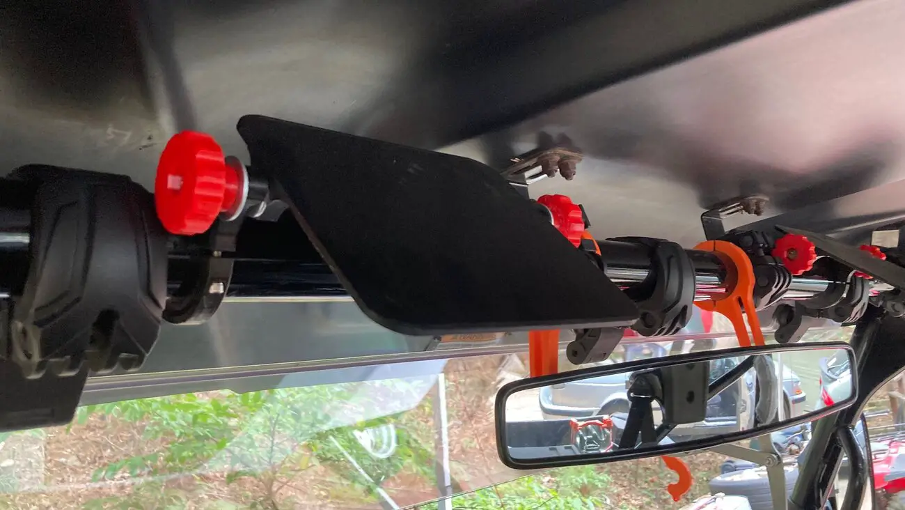

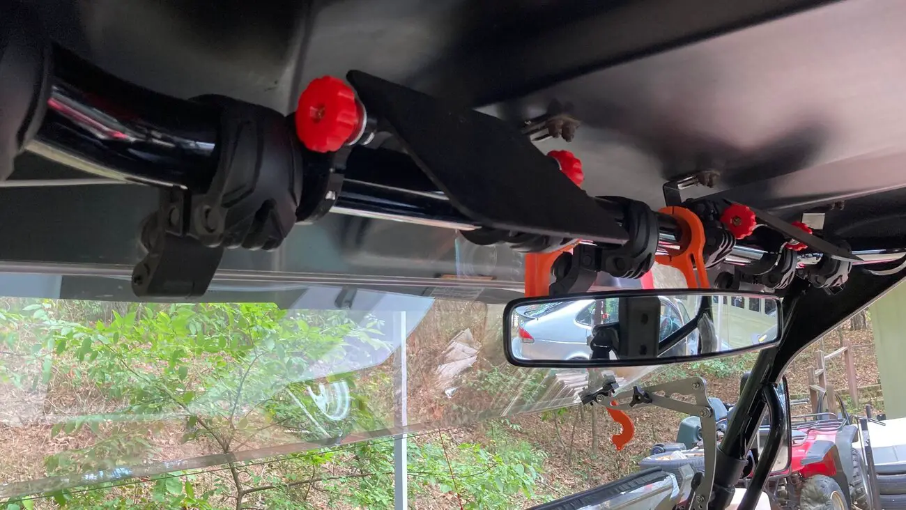

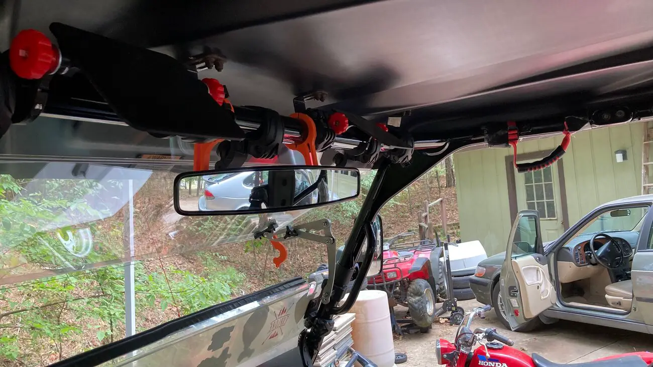

These intercept part of the air that is passing over the top of the windshield when it is tilted out. We found this little trick accidentally when we were putting our hands up to feel how much air was being moved by the tilt windshield. Your hand would deflect the air down into your face. So I Designed and 3D printed a set of roll bar mounted Air Deflectors to mimic our hands into the air stream along the roof. Before these were added, the air that passed over the top of the windshield simply followed along the roof and dumped out the sides or back. This device "scoops" some of that air and directs it to the driver or passenger into the upper body or face area.. Makes a considerable difference in comfort.
View attachment 345609View attachment 345610View attachment 345611
Neat idea, I was looking at printing something similar for a sun visor. You've got the wheels turning. Did you also print the flat part? My printer will only go about 8 1/2 inches square.
I printed all of the parts on an Ender 3 235 x 235 mm bed. Printed in PETG. I was restricted in size by my rear view mirror, but these still work great, in spite of being only about 6" (more or less) square.
