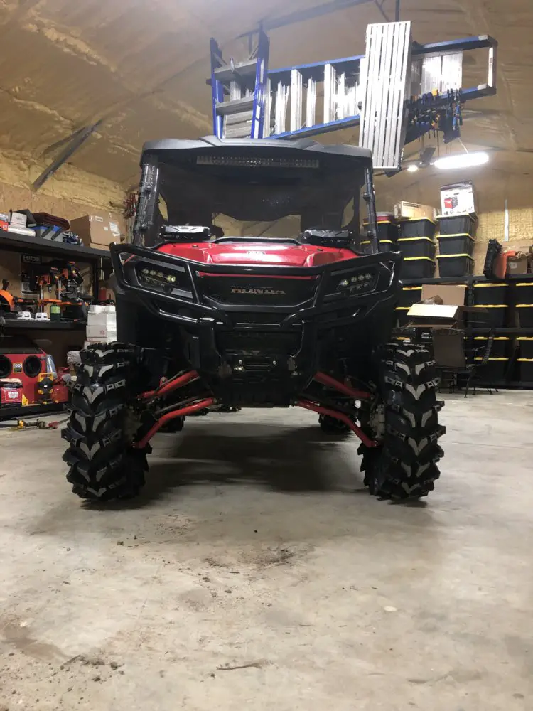

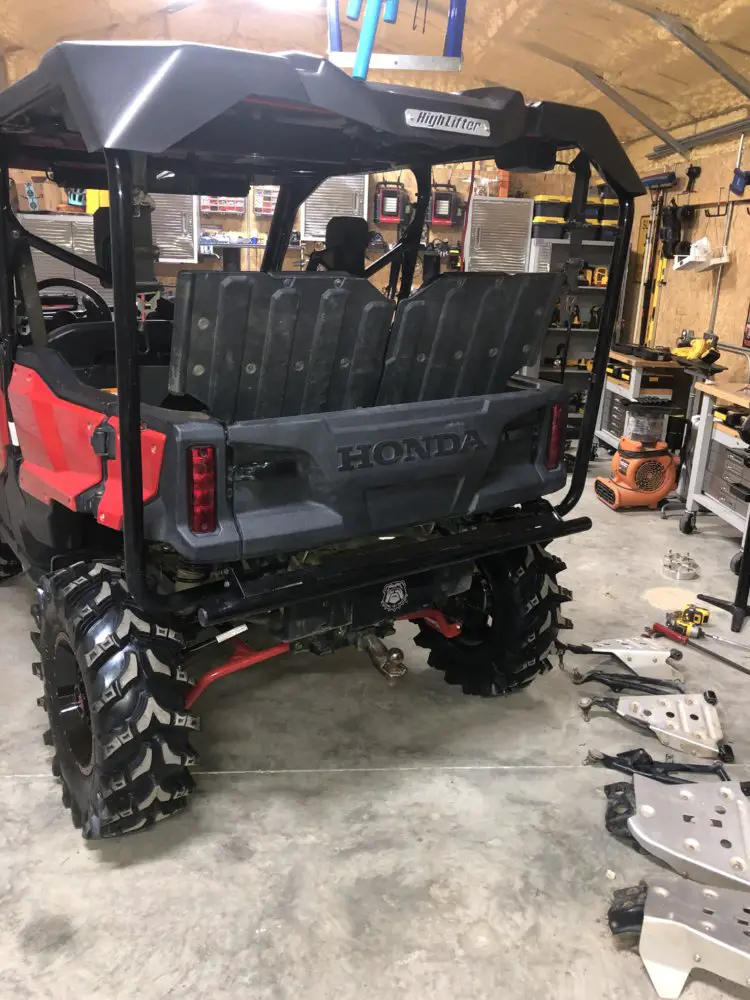

Both are towed in, looks pronounced when empty. I think that's pretty typical for a 1000 5.

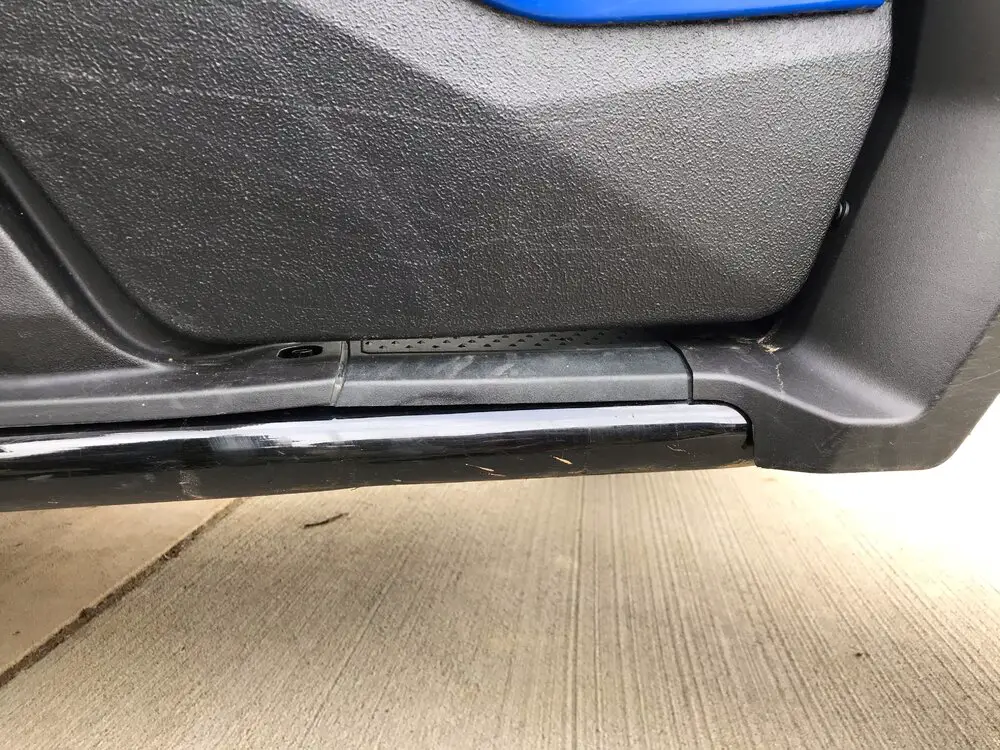

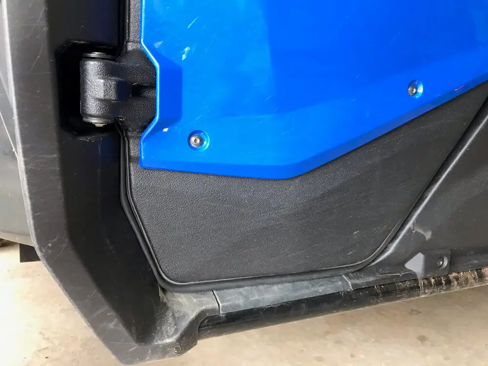

I added the door seal gaskets to the front doors as discussed in another thread. Pictures show before and after. I think it looks pretty factory and am excited to see how much dust it blocks with the new windshield (haven't gotten to try yet). I also tried to pull down a tree in the yard yesterday and threw a check engine light for spinning the back tires too much. The gear indicator went blank. Turned it off and back on and no issues but it's a little alarming at first!

That is the link to the thread and below are the parts from amazon. If you search them it will pop right up.
3M 4298 Adhesion Promoter, 5 Sponge Applicators
3M VHB Heavy Duty Mounting Tape 5952, 0.5" width x 5yd length
3M D-Shape Door Seal 0.59" Height X 0.47" Width, Weather Stripping Hollow Black (10 Feet)
I ordered 20 feet of the D shape door seal in an attempt to start the rear doors but ran out of the VHB Mounting Tape. Adhesion promoters make a big difference to stick. I will add that they make it more difficult to close the doors which in turn makes them not rattle!
