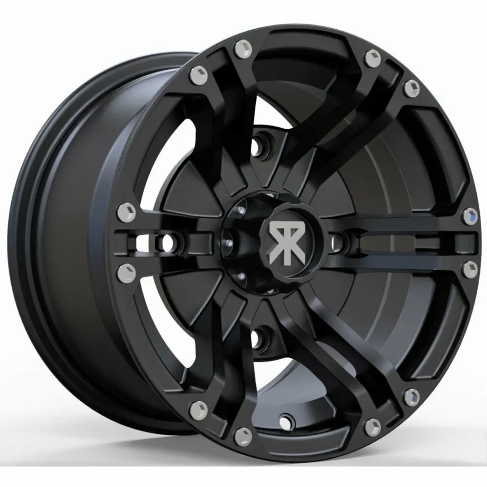

Thanks! That makes sense. Those aren't beadlocks then.
A beadlock has bolts spaced every inch or 2 that holds a separate metal ring on the rim to lock the lip of the tire in. So if you can see that the rim allows for the tires lip to seat without a separate ring then it is a simulated bead lock.
Correct they are not beadlocks.

You can also get fake beadlocks with bolts all around the outside to look like beadlocks. In a true beadlock, the bolts clamp an outer ring against the tire bead.

Are these considered a beadlock rim? I'm not sure what a beadlock rim looks like (other than what the term implies). Also, what size and same size for all four? Nice looking rim!

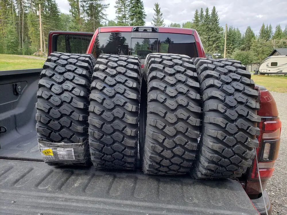

all are 14x7 5+2 non beadlock.they are the cheapest ones i could get that still look ok.they will undoubtedly be trashed within 2 years so really spendy rims on it are pointless,but i can repaint them.i have a set of 28x10 traxion Alphas hidden in the shop to mount on them this coming spring.

Are you going to add a 1” spacer to the rears?
as soon as they have them back in stock.now waiting for the email,then they will be ordered.i was waiting for the email that the black lug nuts and valve stems were in stock and got them ordered yesterday

Thanks for the information. I understand everything you're describing here including the need for spacers in the rear. One thing I'm still not sure of is what the 5 + 2 refers to. I've seen other numbers added together and I didn't think it had to do with the lug pattern. I try to read all the threads on the different tires in case I decide to change from stock on my deluxe but still haven't figured out the 5 + 2 and other similar configurations. I'm also familiar with tire ratios as far as sidewall versus tread with but this 5 + 2 doesn't seem to fit that either.

Stock rims are front 6 + 1, rear rims are 5 + 2 which makes the out side width the same front to back. If you get four 5 + 2 for all corners you will need 1 inch spacers in the rear to even the width out front to back
