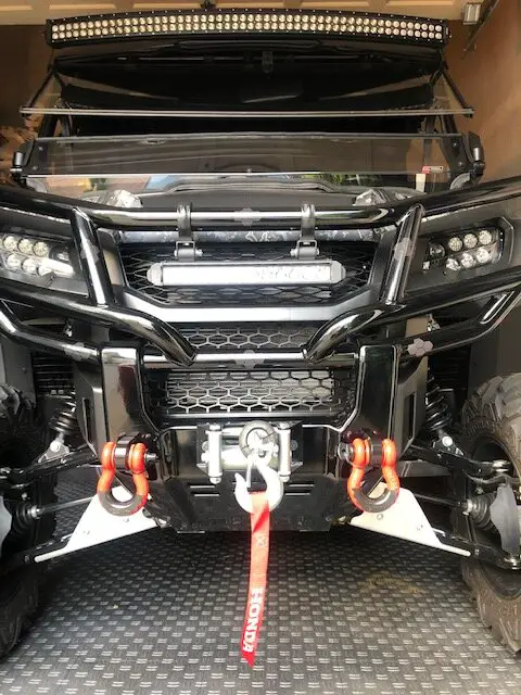

Added some shackles to the front of the SE. No rattles with these as they come with rubber washers.

Could you link to the mounts you used, and did you have any issues?
No separate mount was required to mount the horn. Fortuitously, there is a thin slot on the horn compressor motor casting that is adjacent to the single bolt mount. The provided bolt mount is not used. Instead, a regular stainless steel hose clamp is threaded through the thin slot. Next, a short length of rubber "heater hose", or similar, is slit lengthwise to fit over the steel tube fender support (if you are using a larger diameter piece of hose, I used 1" ID, then remove an additional cut-lengthwise piece so the hose just fits around the steel tube). The hose clamp is cinched up tight on the rubber hose. This provides a very secure mount that still has a degree of vibration isolation to protect the horn.
I did not have any issues. I used rollbar paint and painted them black and then taped off the bumper to align them correctly with marks. The metal plate provided enough backing that it feels pretty solid.
The shackles, in the link above, have beveled bases. This is fine if you are going to weld them on, but not so good if you are only bolting them on. The reason this is so, is the smaller narrower footprint of the beveled shackle base results in more bending moment being applied to the bolts with any lateral loading. If bolting only, I'd recommend something like these:
Shackle mount
Bolts are 3/8 - 16 X 1-1/4 grade 8
Bolting and welding doesn't make a lot of sense either, as if welding, the mounts should be positioned in line with the bumper mounting struts that are on each side of the fairlead, as this would result in a stronger overall mount for the shackle. If bolting only, the shackle mount wants to be as close to that inside weldment as the backing plate will allow.
You're not going to want to pull to much with those. Assuming the SE has the same bumper structure, that's not very thick stuff.
