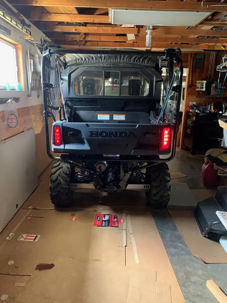

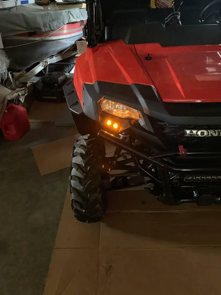

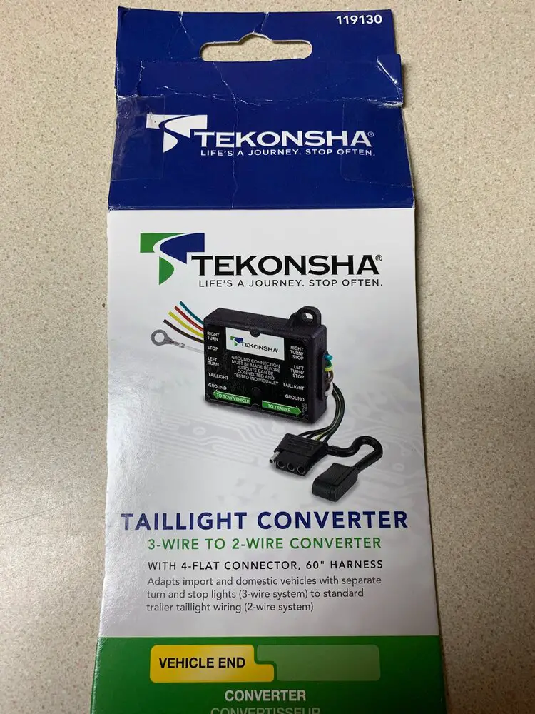

Finally had time to install turn signals on the hunting rig.
IMG 2847
IMG 2860
NewHere2
NewHere2
Village Idiot In Training
Mar 9, 2020
57,017
401,275
High Plains of SD
Looks great. Link to where you bought them?
I picked up the supplies locally. The 4 - front 3/4" Maxxima (M09300YCL) LED lights and 4 - double Grote (66165) female connectors came from a Great Dane Semi Trailer shop.
IMG 2863
The Tekonsha adapter and a 3-6 bulb LED Signal Stat (flasher unit must be for LED) I got at my local auto parts store.
IMG 2842
Then I used a 12ft. piece of double 14ga. wire I had. HOPE THIS HELPS !

I picked up the supplies locally. The 4 - front 3/4" Maxxima (M09300YCL) LED lights and 2 - double Grote (66165) female connectors came from a Great Dane Semi Trailer shop.
Good stuff. Thanks. Way over my head, but I bet someone local could handle it for me

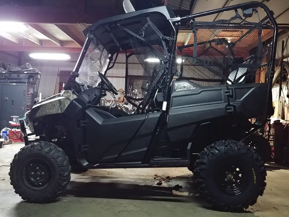

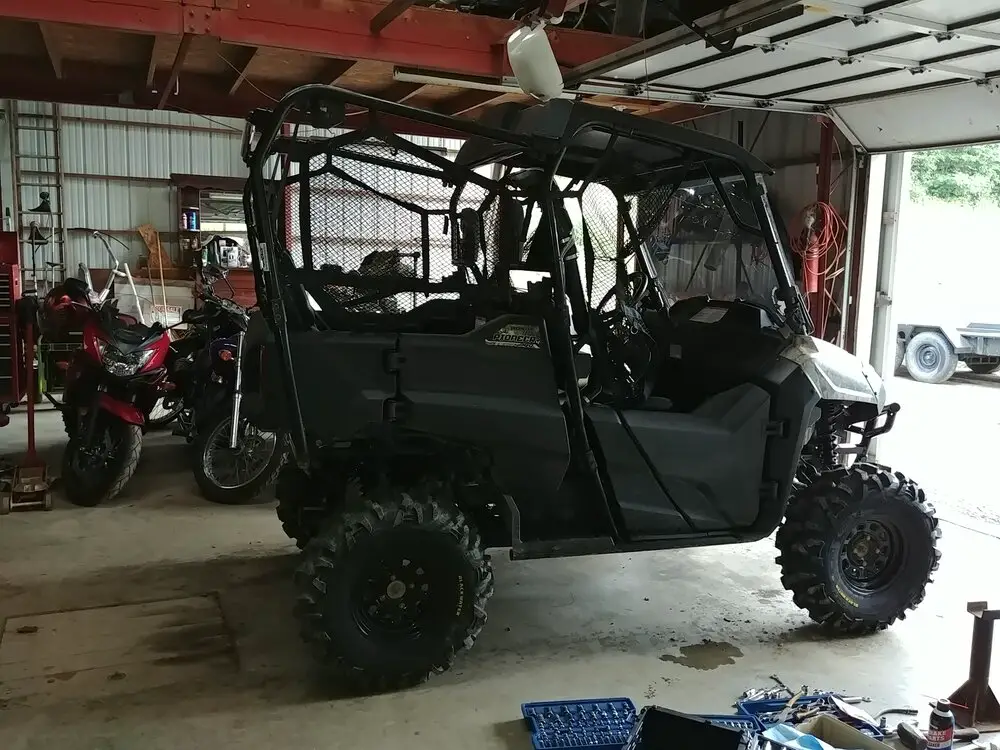

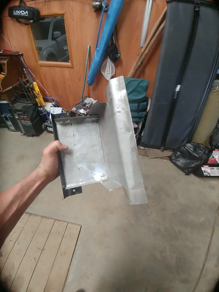

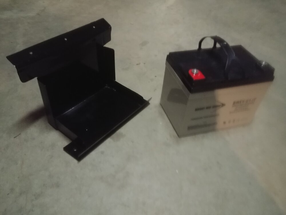

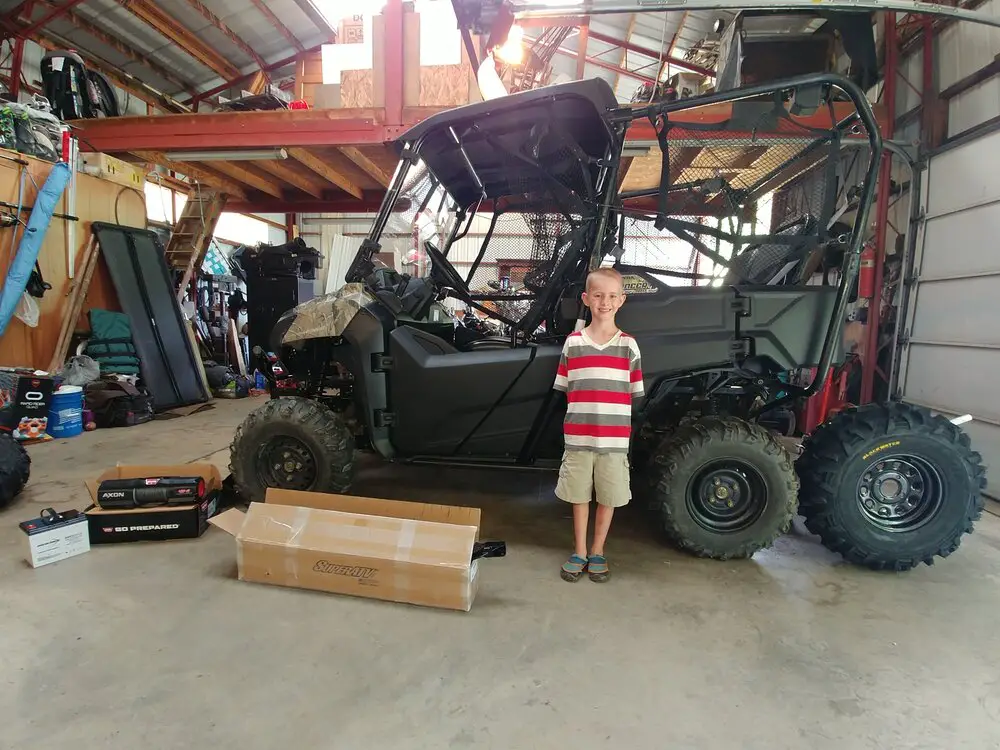

Well... Not today, but in my time after work and family in the last 3 evenings, I've made quite a change in my previously stock P700-4. I'll say first I had the snorkel (Warrior Riser kit) installed last month by the shop that I got it from, as it was an agreed condition of the deal. I started with the rear lift and tires (RMATV/MC only shipped 2 at a time) thought to myself cool I'll make it look like a sprint car. (Ok, maybe with 8" front wheels. 😆) worth a try and the hardest part of this lift was then out of the way. The next day the other two tires/rims arrived along with my winch mount. I finished the lift and wheels and mounted the winch. Saturday I started building a battery box for under the hood, went for a swim with the family while the paint dried and that night I was up til 5AM finishing the wiring.
View attachment 214724 View attachment 214725 View attachment 214726 View attachment 214727 View attachment 214728 View attachment 214729 View attachment 214730 View attachment 214731 View attachment 214732
Great job. Looks awesome. 😉😎

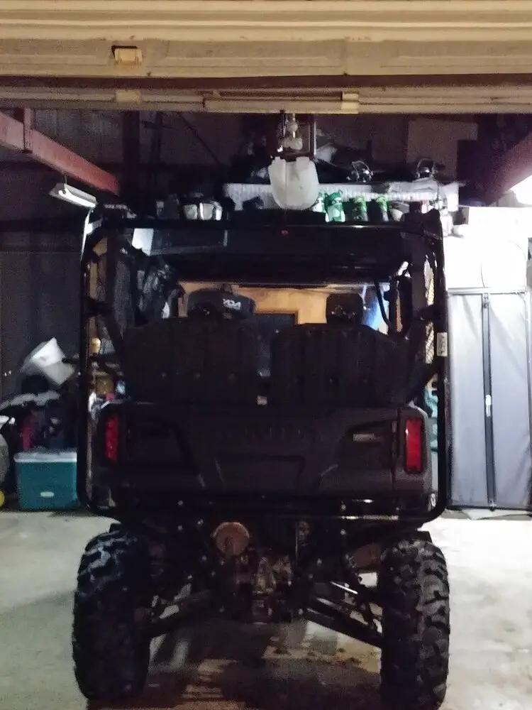

Well yesterday was a cluster and nothing went right so I figured the bolt pattern on the new exhaust tip wouldnt match up, but it did. Definite reduction in noise from zero to about 30 and a deeper sound. Also after about a 10 mile run the bolts changed color, but the tip stayed chrome. I hear the black ones change several times before settling down. Sorry for the blurry 2nd pic showing bolt color.
20200729 113909
20200729 194653
livefromthetree
livefromthetree
It was a damn good ride. Seriously good.
Jun 4, 2020
464
1,299
Mount Vernon Indiana
Did you fab or buy it? I'm always interested in quieter.
Saw a post on the Honda Pioneer 700 group on FB. This Yamaha tip is an exact fit for the Pioneer. The original poster said that they sent him one at first that didnt line up, but everyone since then says they line up fine.
