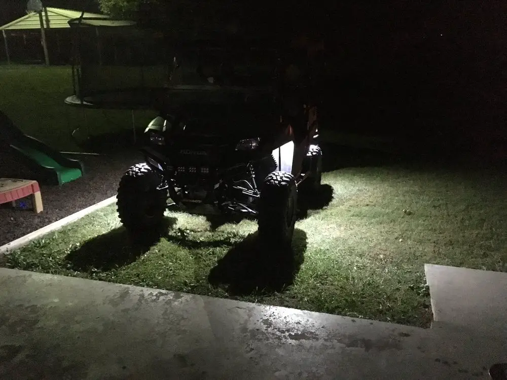

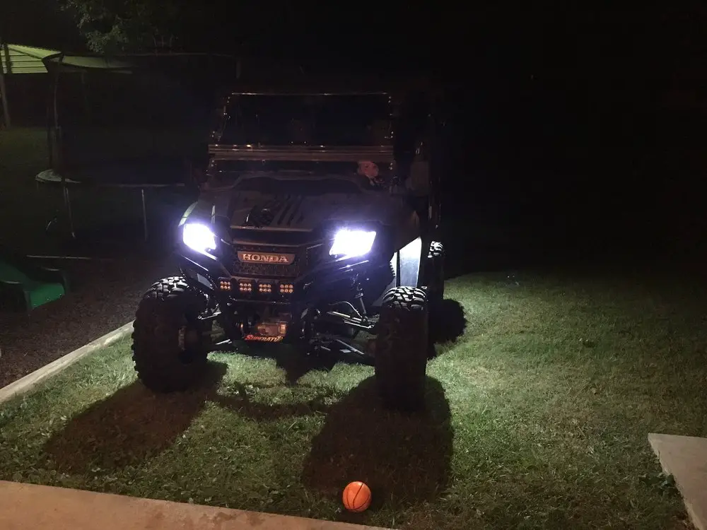

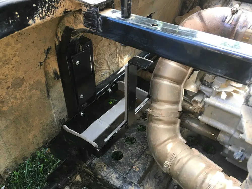

after a good 2 days of working on it.. added rock lights, flood lights, driving lights, floor board lighting, made a battery box for 2nd battery and installed the battery switch. Also faced a couple marker lights into the headlight housings.. mix of halogen and led lighting bugs me so I wired it where I can run all the rest of the lights with the halogen bulbs on their own switch.

If you're talking about the rock lights, on the front I made a little tab for them and used double side adhesive to stick it inside the fender. On the rear, I used some coarse thread bolts and screwed them into the plastic part of the bed just rearward of the rear doors.
