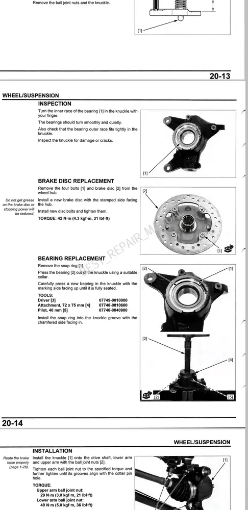

Stateboy
Stateboy
Apr 5, 2021
299
1,740
Wolverine, MI
This is what I found in the repair manual. I'm not sure if it will help. Also, welcome from Northern Michigan. 69aa9a9cd847b4e2a37f797a840f7881

This is what I found in the repair manual. I'm not sure if it will help. Also, welcome from Northern Michigan. View attachment 269190
Sent from my SM-N960U using Tapatalk
Thank you for the response! Honestly I wish they gave dimensions in the manual. The OD of the tool is just under 1 5/8” so I think the 44mm tool is closer to what I need but I don’t want to order and cross my fingers. It seems like most of the sellers on eBay and Amazon only go to about 2017-2018 in the description so after looking deeper I wondered if the 2021 model maybe had a larger bearing. Thanks again for posting!
