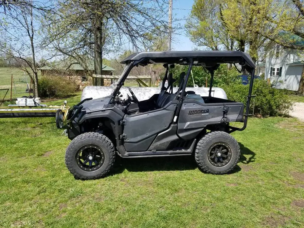

I looked at 16"s but didn't think could fit any of them with no lift or arms . 5x2 offset 235/75r-15 already did some grooving. Super happy so far ! 95c5f3b21f902f28845c9362312edd456ed66128ba5102be6a2ebd901d70d6bf4375130ea44e70f72bc2e93e4411339cCe2a55ae6dfdb3b0ba9ef67ef4360c38

I looked at 16"s but didn't think could fit any of them with no lift or arms . 5x2 offset 235/75r-15 already did some grooving. Super happy so far ! View attachment 80058View attachment 80059View attachment 80060View attachment 80061
If I understand you correctly, you are NOT running any lift or arms? What is actual height of tires? Any rubbing? Same size/width front and back? Same overall width front and back or is wheel offset different? How they do in mud, hills and rocks? So tires and wheels little less than $1K total?

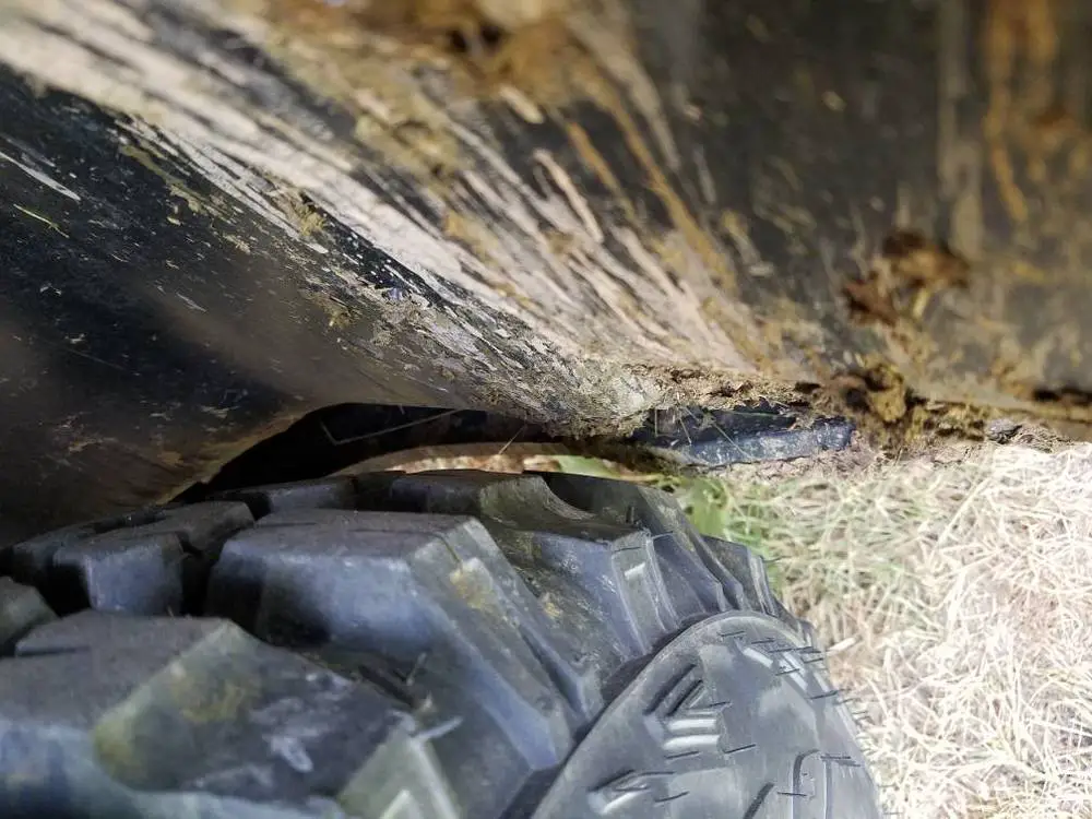

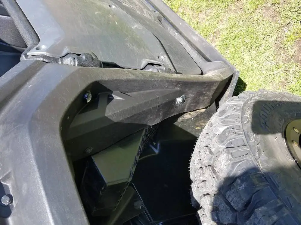

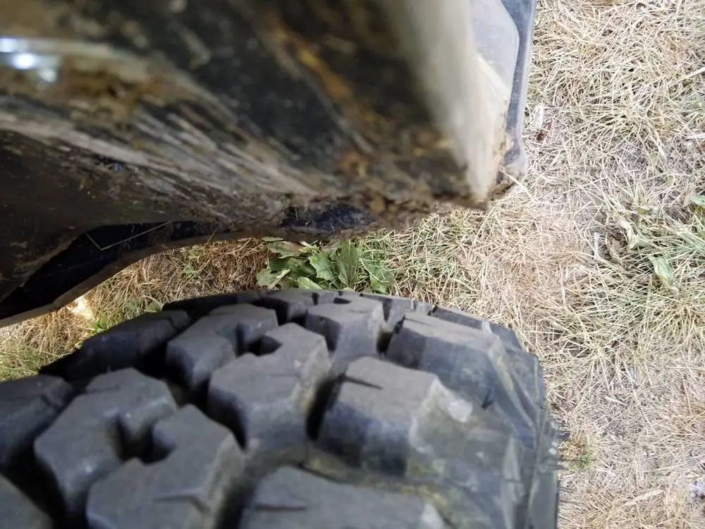

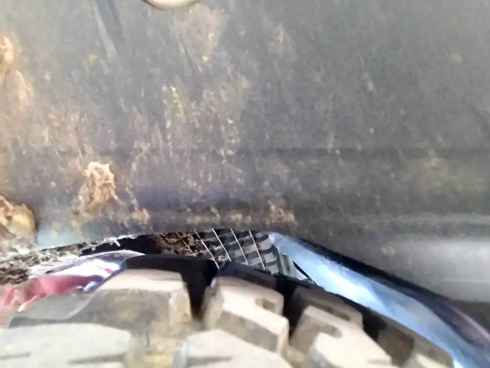

Same size all around 1"rear spacers 5x2 offset I got tires for $97 a pcs $ 620 wheels and spacers . So $1008 total I think beadlock was over kill plus kind of hard to setup with truck tires . Could save some money with no beadlock ! And you are correct no lift no arms and no rubbing I did have to add one screw on the fender flare because at full compression turned slightly if you were to turn the other way and tried to pull out the fender flare see pics and I had to trim trail armor skid plate. Seemed good on rocks and Hills I don't really play in the mud much but they are MT so should be ok .They are very close but I've had no problem. I always figured when it was time for new a arm bushings I would put the super ATVs on there just for a little more room, right now if you are in some sticky mud and Clay you can hear it suck a rock through every once in awhile.82be5eb489e6f788efcaa87c7156a7444fda48c5fba9429acb3028831ed8d4f3C0b9706f251f000e7536a321ebc8b6328747160c6673a75ac1cdbb38558b1f7a

Same size all around 1"rear spacers 5x2 offset I got tires for $97 a pcs $ 620 wheels and spacers . So $1008 total I think beadlock was over kill plus kind of hard to setup with truck tires . Could save some money with no beadlock ! And you are correct no lift no arms and no rubbing I did have to add one screw on the fender flare because at full compression turned slightly if you were to turn the other way and tried to pull out the fender flare see pics and I had to trim trail armor skid plate. Seemed good on rocks and Hills I don't really play in the mud much but they are MT so should be ok .They are very close but I've had no problem. I always figured when it was time for new a arm bushings I would put the super ATVs on there just for a little more room, right now if you are in some sticky mud and Clay you can hear it suck a rock through every once in awhile.View attachment 80064View attachment 80065View attachment 80066View attachment 80067
