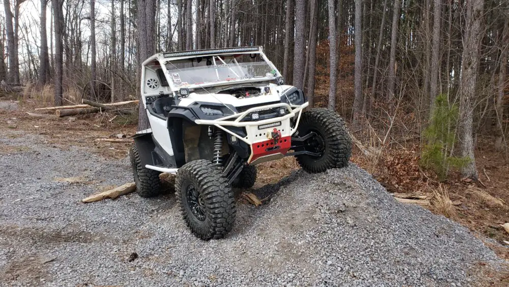

@snuffnwhisky , did you replace the stock side tubing when you did the kickers or is that angle on the sides over the stock tubing? Knowing you, I'm guessing it's square tubing since those stock siderails crumple like a tin can. I really like that style of kicker.
Reactions: BWAF and sharp
snuffnwhisky
snuffnwhisky
Village Idiot
Sep 21, 2016
3,308
18,181
Cullman, AL
  2. Other Brand
I wanted to but didn't. I welded 2 x 2 x 1/4 angle to the stock tube and built off of that.

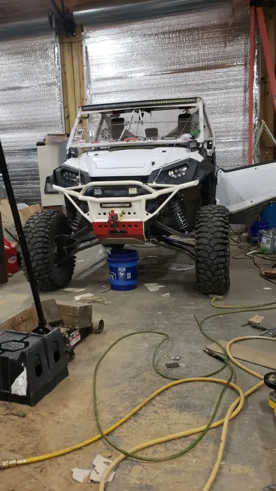

This is kinda majoring on the minor but I like the way You put those flush mount lights in Your radiator cowl behind the bumper do they work good???
Reactions: BWAF
snuffnwhisky
snuffnwhisky
Village Idiot
Sep 21, 2016
3,308
18,181
Cullman, AL
  2. Other Brand
Yea, the lower corners are good unless u are in a lot of mud. But a lot of mud pretty much blocks all the light up front.
