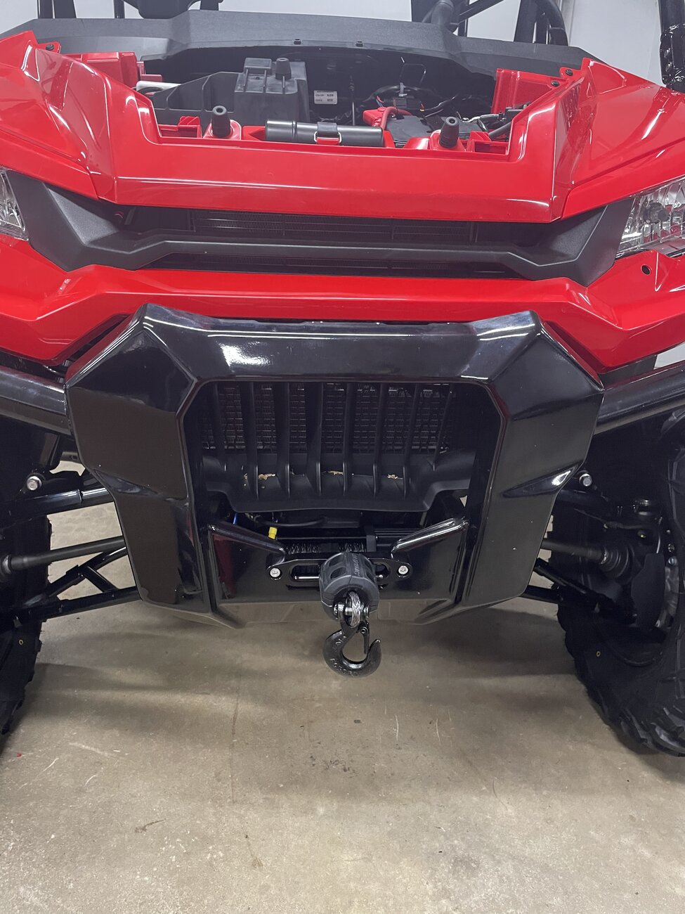

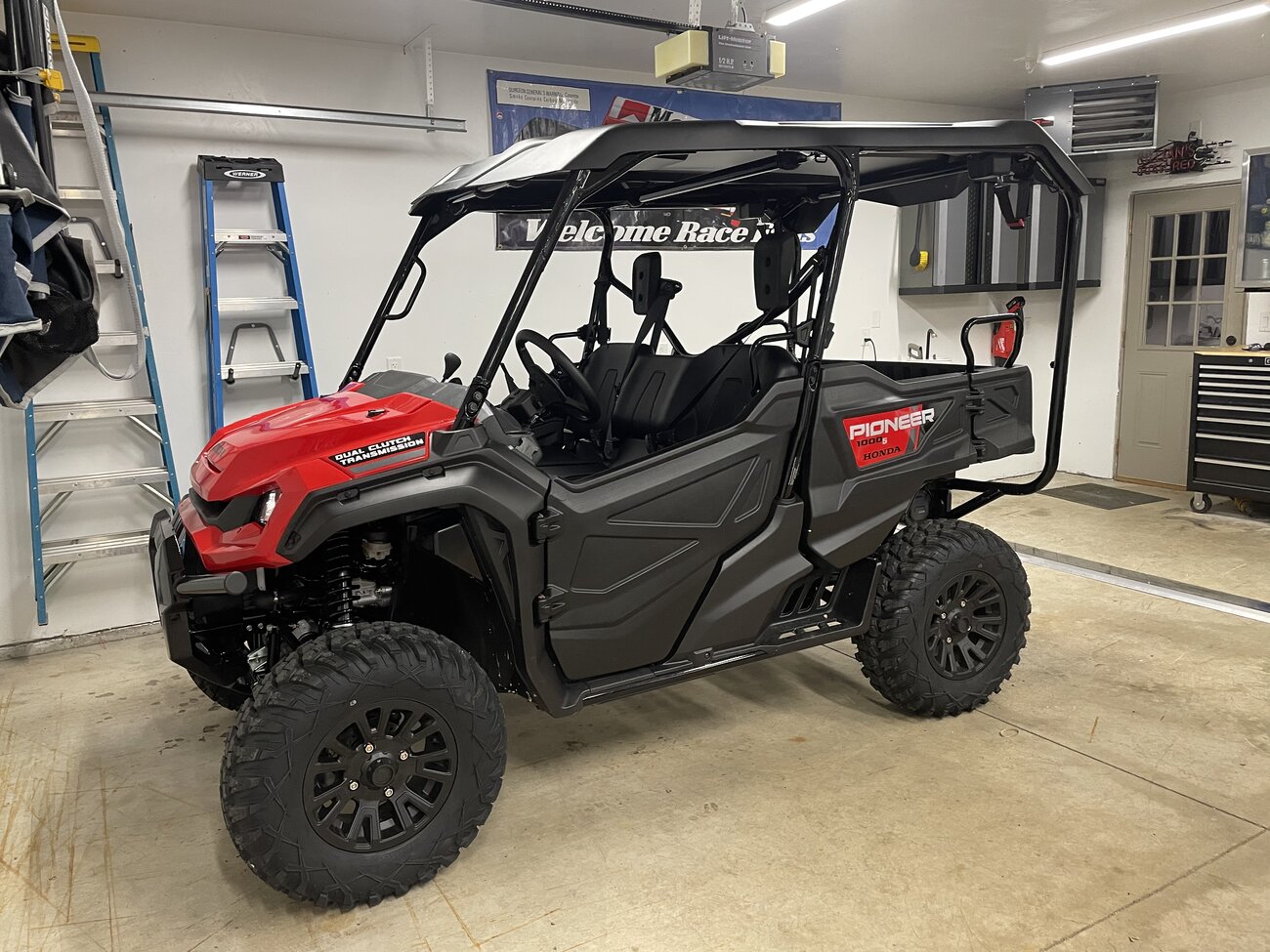

Maje1
Jun 21, 2022
10
27
Winneconne, WI
Hay you! No pics from you yet Of your rig! Now the SATV winch 🤨 😂
Rule #4 Pics Or It Didnt Happen!
@Remington here you go buddy.

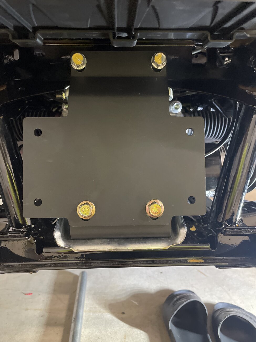

Nice rig! And thanks for posting pics. Good idea with that gusset plate.
As I always say, its not for me! Im doing it for the people By the people! But thanks for the recognition. ;)
The gusset plate portion is actually what comes with the P1000 Ready fit kit with the SATV winch. as you can see the plastic grille is flexed up a little bit above it….I forced it back in. Working for now….
