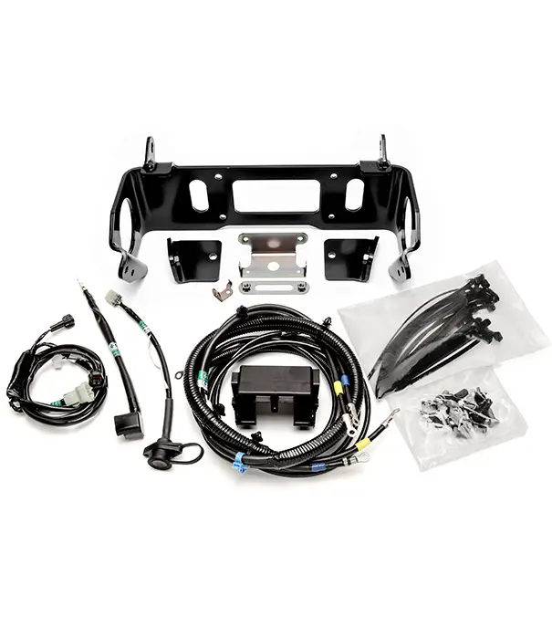

P1000 Winch Mount Kit - 08L72-HL4-A04 - Instructions 2015-11-06

OMG...
Who ever wrote these instructions needs to be shot.
Took a 2 hour job and turned it into a 2 day job!
There is no way in hell I am going to take my entire front end apart.
Reactions: CharlieNJoy
32,051
Wait, you have to raise the dump bed and take the gas cap off to install the winch?
Did someone copy and past instructions for another accessory into the winch mount instructions by accident?
God forbid you ever have to replace the winch line. Might as well buy a new Pioneer you'd have it paid off before you got the old winch off.

Has anyone received this winch mount kit from Honda. I purchased one in late October at Honda of Russellville and it still hasn't arrived. They keep telling me it's on back order.
I ordered mine from Babbits online in mid November and it just shipped yesterday and arriving Monday according to them. I had asked to cancel two days ago so I could get the KFI one instead but I'll roll with the honda mount since it's coming.

I got my Honda mount yesterday and when I opened it it did come with some factory electrical stuff for the install. Not as cheap as the KFI but does come with some other stuff than just the plate.

I just finished installing mine the instructions are ridiculous i did not follow them to run the wire to the chassis ground and drill a couple holes. I made all connections at the battery. Also the winch contactor is setup to go in the same spot as the accessory fuse panel so I guess they dont expect you to have both. I only used the mount, the cables that run to the winch, and the accessory harness I cut up and spliced in the Warn wireless remote. I used the red/black cables that came with the Warn 4500 winch kit and didnt have to cut or crimp any ends.
The winch cable angle is about 45 degrees coming up to the bumper, so the the Hawse fairlead is not going work well. The backside of the fairlead has a hard edge and would cut or wear the line eventually. I think I am going to order a roller fairlead for mine.

Took my 1K5 back to the dealer yesterday because they called and said the winch mount was finally in for the Honda pro vantage 4500. Part of the deal with my purchase was having a winch and install included. Picked it up at closing today. The tech that did the install said it was the most aggravating winch install he has ever done. He said he worked on it all day. So I guess the sales department will take a little hit to cover all that labor. lol. He left the install instructions in the glove box. DAMN! had to basically disassemble the whole machine.
I will say this. It's a very clean install. Not really happy about the remote connection in the glove box. The connector is not a very good solid connector either. Can be very easily pulled out. And I'd much rather have a switch on the dash. So when I get time I will be installing a switch in the dash somewhere for sure. All in all though I'm happy with it and how well protected the winch is.

I used the Honda Mount on mine. I'd go with the KFI mount knowing what I do now and saved $200. Read the honda instructions and decide especially if you are installing yourself.
