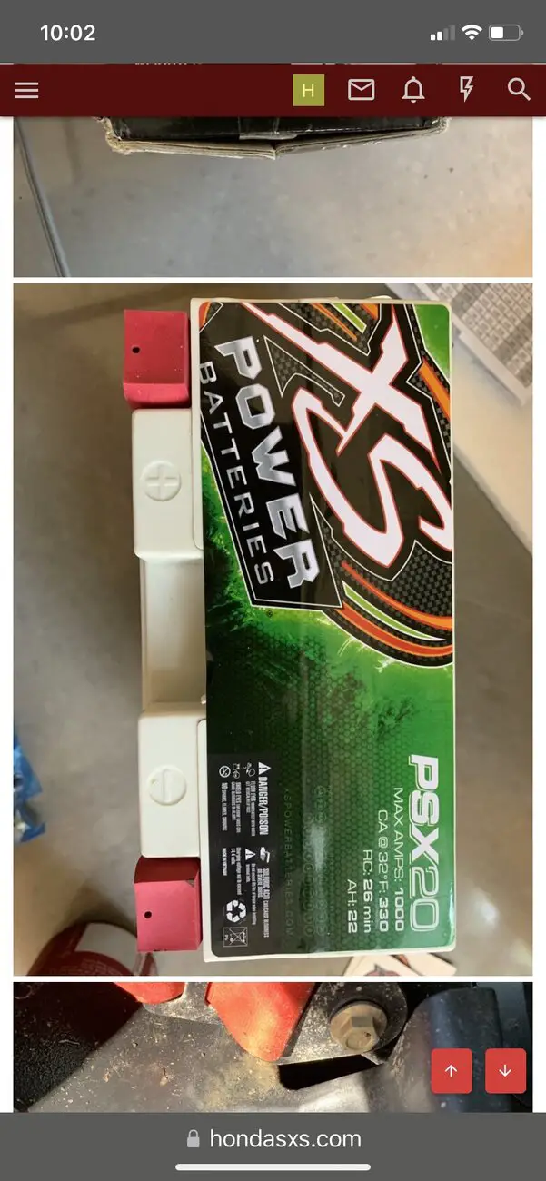

I screen shot these pictures a while back from this site for future reference when I needed to replace my battery. I believe this also is a bigger battery that will work if you remove that plastic piece at the bottom of battery tray. Correct me if I’m wrong.
View attachment 369073 View attachment 369074
Wait…. Shut the front door!
He says in the pick he put it on a bike! You sure its for a SXS? 🤣 Dont mess the OP up now!🥳

Here's the battery that I used. I was going to try one with 270 CCA but this one actually had 310 CCA with just a little more height. Like @DG Rider said there is a little piece of plastic that needs to be removed in the bottom of the tray, but I did get it to fit and it worked well for me. Like I said you might be able to add a test second battery with a set of jumper cables to make sure that low starting current is the problem, before you add a bigger battery but it was my problem. I did a lot of research and found that the similar Honda Rincon motor would actually stop firing the fuel injectors if the voltage dropped too low ( I believe 10.8 volts if I remember right). I think this was the main problem as it would drop in voltage enough to crank the motor but not fire the injectors. Hope you can find something that will work, but my 700 was the worst thing that I have ever owned when trying to start in the cold. Very temperamental and VERY frustrating.
