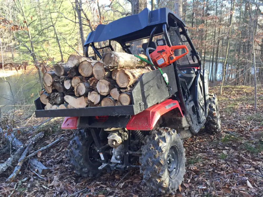

Been looking for cargo box ideas and I appreciate all of your photos. I'm going to use mine to haul firewood mostly. Thinking of going this route. 30" of box length with a little 5" hinged storage space for tarp, chainsaw tools, and tie-downs. It's all 3/4" plywood with some easily changeable 1x boards for durability in a few key areas.

Also - I added a gun rack inside the box, and the ring tie-downs to the sides, reinforced and bolted thru some heavy dudty L-brackets. The shelf brackets near the back hold a 2x6 if I need a taller gate. The lip across the back is white oak, hard as nails

Nice job. How did you attach it to the rear rack. It's not clear from the pictures.
