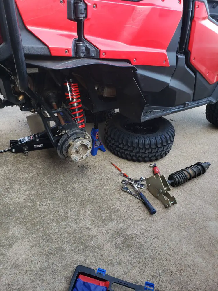

I bought Eibachs for the rear: 14" @325#. They only came in silver and cost $215 delivered total. I've seen some forum members find red shocks for $75 each, but don't know where. I use my machine the same as you, by the sound of it. I am 100% satisfied and good with the decision to install Fox QS3s all around. I'd recommend 300# or no more that 325# spring rate. I had talked to Fox sales, and got handed off to an engineer to answer my questions, and the engineer concurred with my need for the increased spring rate. I used a wall mounted spring compressor at an auto hobby shop that I have access to, but I'd guess most powersports shops could do it for a reasonable fee.

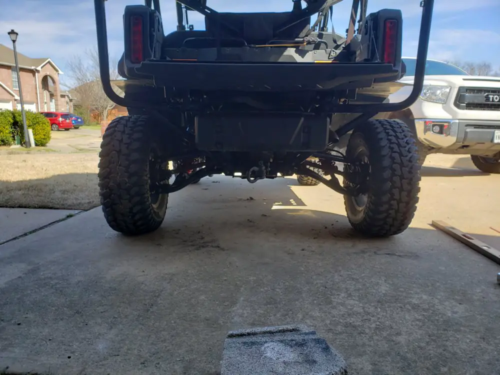

Removed my rear lift and installed the fox rear shocks today. Camber is a little positive but I'll drive it a bit before making adjustments. It should settle some.

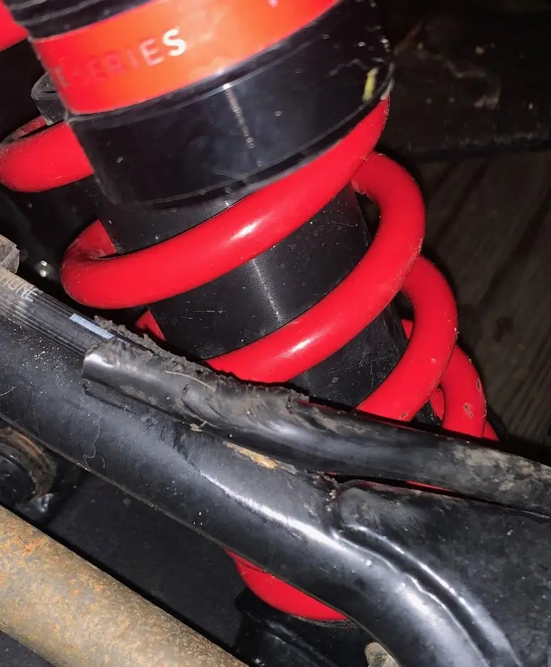

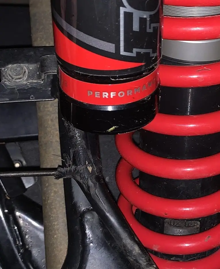

View attachment 187244View attachment 187245
Your rear shocks are on backwards. Reservoir should be towards the front. Under full compression like that your res will hit the brake line/arm.
I put mine on backwards also. Smashed my brake lines. I was lucky it didnt damage the reservoir. I replaced my brake lines and kept the smashed ones for backup.
I was torn on which way they went, seems like I've seen them both ways. I'll flip them, thanks for the heads up.
