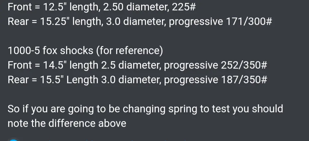

A few months ago I canceled my order from Ron Ayers for the front shocks for my 1000-5. I had them send me some for a 1000-3. I think (someone correct me if I'm wrong) the only difference is that the spring rate for the 3 seater is 225 pounds compared to 250 pounds for the 5 seater. I was changing the red springs to black ones anyways so that didn't matter to me. At that time they had quite a bit of those in stock.

That was May 23 when I ordered them. Also they had 12" long springs. I replaced them with 14" long springs. Idk what the spring length is for the 1000-5 front shocks. They defintely ride alot better than the stock ones.
Screenshot 20220710 153238 Samsung Notes

Good info. And I think 225 pounds in the front would be too light
I'm still running the stock fox springs on the front of my 5 seater. 300 lb springs on the rear. I think it rides really good. The first springs I bought were 300lb 2.5 inch diameter. You can run them in the rear If your take out the plastic insert. I chose not to, so I got the 300lb 3 inch springs. When my 3 seat started sagging and I cranked up the preload to get my ride height back, it bottomed out on every small hit at 15 mph or more. So I put on those 300lb springs that I had bought for my 5 seater. It was the worst riding machine I had ever drove. Rode like a log truck but it never bottomed out. If you drove it 20-40 mph on the trail, it rode pretty good. @joeymt33 gave me a set of 2.5 inche 275lb springs and it rides really close to comfort of my 5 seater now. I still have the stock springs on the rear of the 3 seater also.
