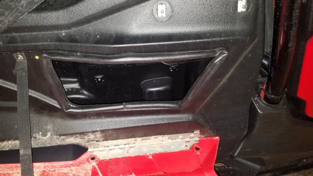

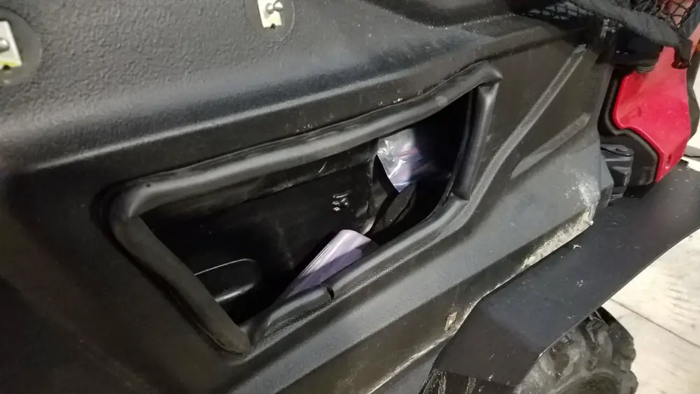

I went with this weather strip. I have sprayed too much SC1 to try and get something to stick to the plastic. Lol
It will help prevent water and mud from entering around the opening. It certainly isn't a sealed storage though. I purchased on Amazon. It was $49 for 30'
View attachment 98901 View attachment 98902 View attachment 98903
Looks like the one I did on post [HASHTAG]#294[/HASHTAG]&301 but yours looks a little bit Wider maybe cover some more area . I haven’t had a chance to try it yet and see how it does.
20,363
116,566

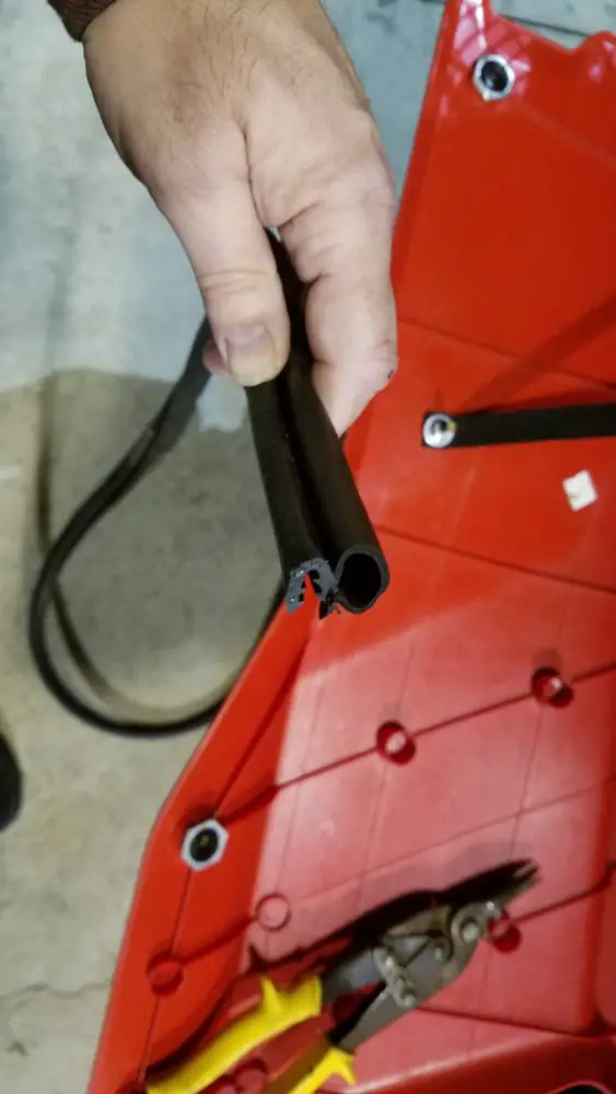

Yours is adhesive and mine has the u channel to hook over the edge. The adhesive wouldn't stick on mine.
Roger that. I use 70% rubbing alcohol to get rid of the SC1 to make things stick. That’s the only way I could get my stickers to go on. But that is a good idea and alternative you have there.
@Remington - I ordered the same as yours after you ad posted about.. I have been out a couple of time and it seems to help. It has not been real dusty the last few times out but I do notice that there is min amount of water if any after washing the Honda on the contents that are close to the door hole
20,363
116,566
Sweet! Good to know. It was an idea I had from buying the seal for an RV I was fixing up. Had half of a roll left over and thought??? What the hell! Couldn’t hurt. Sounds like it was better than a couldn’t hurt! Lol thanks for the report.
