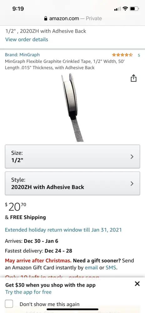

Hey DG- sorry to hear of your frustration with this. As mentioned in my original post, I wrapped some graphite around the end of the header pipe that goes inside of the clapped tailpipe piece. Have to be careful not to have tape beyond the end of the header pipe as this could break loose and plug muffler end of exhaust. Since doing this on mine I have not heard the noise after ~300 hrs and going. I’ve seen and repaired other small engine OEM exhaust that used graphite seals at similar joints, which have me this idea.
i can send you some of the tape if you reply with address. It only takes a few inches of the tape. Or this photo show what I bought on Amazon. Good luck and Merry Christmas!
So what did you do with the graphite gasket that's already on there?
Thanks for the offer. I'm going to try clamping it next.

I wrapped the graphite tape over whatever seal was already there- just one layer. If I recall correctly I had to spread the other pipe end a bit to fit the newly wrapped end into it.
Yep. The fluted end of the rear section usually needs to be spread open a bit.

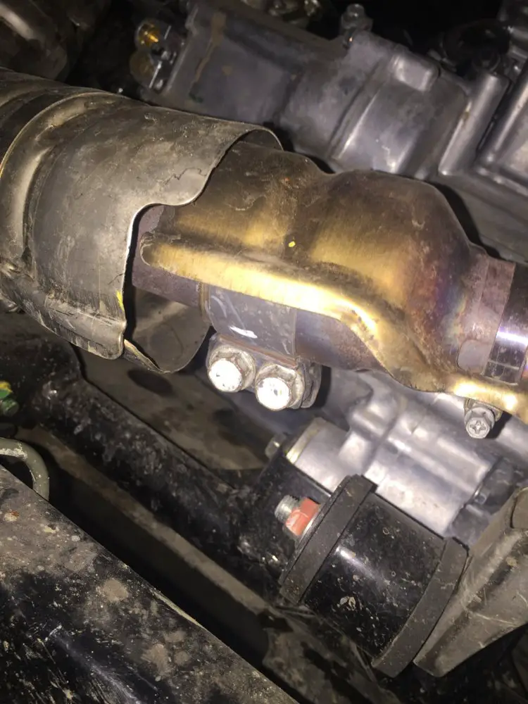

Hello, 2021 pioneer 700-4 with same chirping sound.. I have tightened clamps for exhaust and I still have the sound. After further investigation I started to believe that the mount for the exhaust to the frame is the culprit? Anyone else think so?
It can...yes. BUT...even tight as hell, my clamp wouldn't stop the squeak eventually. My automotive clamp is still keeping it quiet.

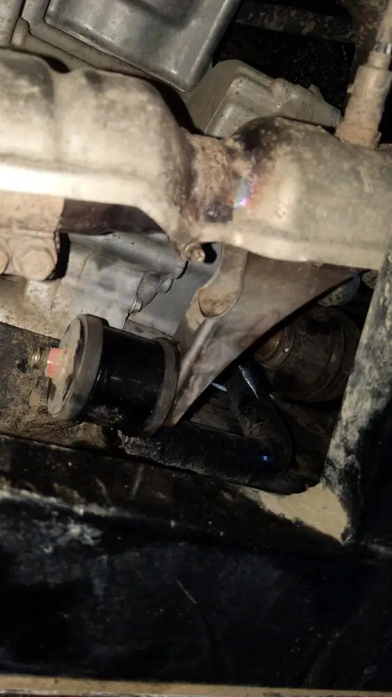

I have no reason to rule out the frame/mount as the source of your squeek noise. I'm now at ~1,200 miles since "fixing" mine and it has not returned. I did nothing to the factory frame/mount setup, just added graphite gasket to the joint and cranked it tight.
