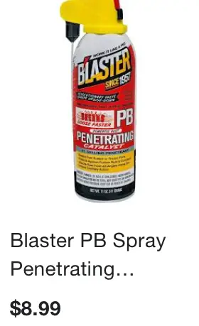

Soak it with PB blaster, let it soak a while. Regardless if the adjustment is the problem, it needs to be loose for future adjustments. Any codes displayed on dash?
Best penetrating oil I've ever found! Use it at work all the time.
