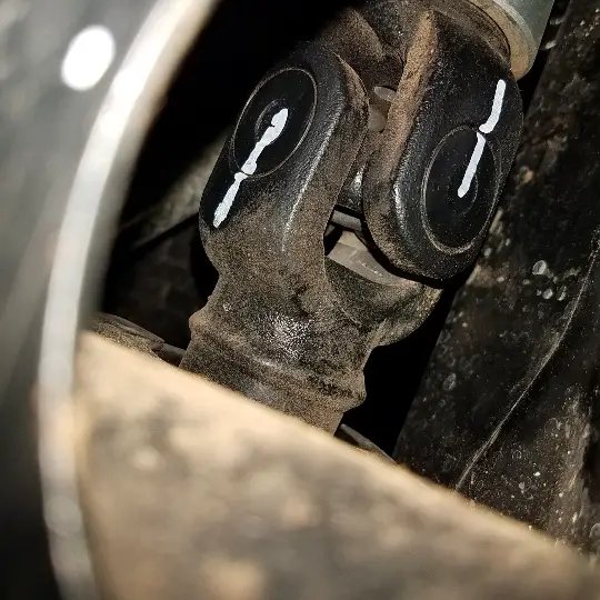

The Eibach springs made a huge improvement. I run with the swaybar now.

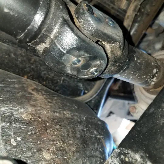

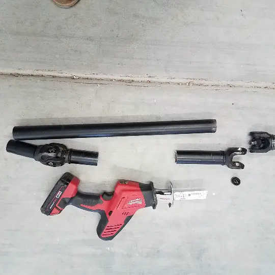

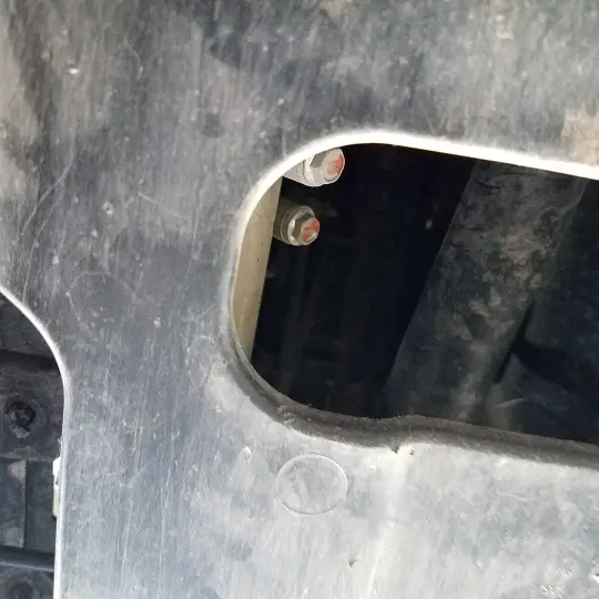

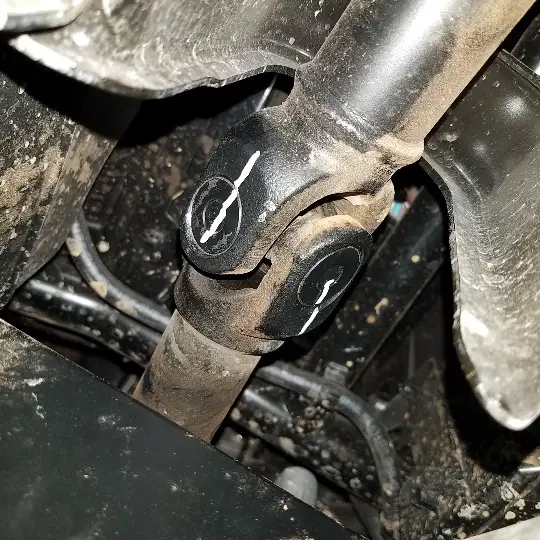

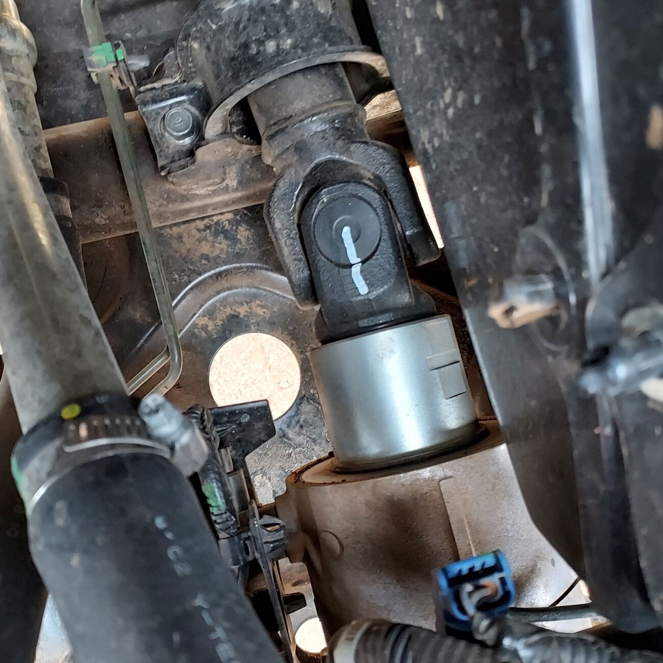

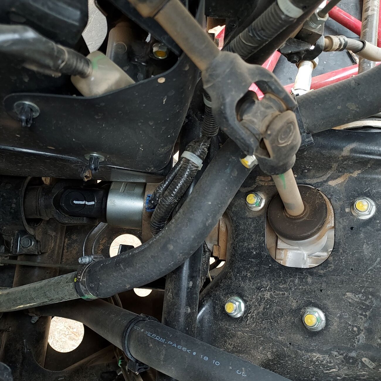

I marked the bearing cups and so far no problem. I inspect them every 200 miles. If the bearing cup turns its time to get both U-joint bearing cups spot welded. If I’m way out and have a bearing cup failure I carry a saw to cut the driveshaft in half so I can pull it forward off the sub trans. I can then drive it out in 2WD without the drive shaft turning. There is room to cut it through the coolant drain hole in the skid plate.

Thanks Hondabob for the information but using the Dycem will work if the cup works out gradually suddenly. In the past have the cups failed gradually or suddenly? I like the ideas about the saw to remove the shaft and go to 2WD to get back to civilization. Just my thoughts.

Forgot to mention you will need a 9 inch saw blade. My buddy had a bearing cup come out in around 300 miles on his 2021 Talon. My 2019 Talon went 15,000 miles and had lots of play where the C clip wore into the yoke. Both replacement drive shafts lost a bearing cup in less then 3,000 miles. I had the forth one spot welded before my dealer installed it. I was close to camp with both bearing cup failures but it sucks to drive slow for a couple of miles. There will be a lot of banging but its still driveable. It took 3 miles at about 10 mph to damage the yokes.

My 2020 Talon is at 4,600 and some miles now and no drive shaft problems. I check to see if the bearing caps are turning every few hundred miles. One of the guys has a bearing cap turning on his 4 seat Talon. I expect the U-joint problem is still small but it doesn't hurt to mark the bearing cups, there is 3 U-joints on the 4 seat model.
