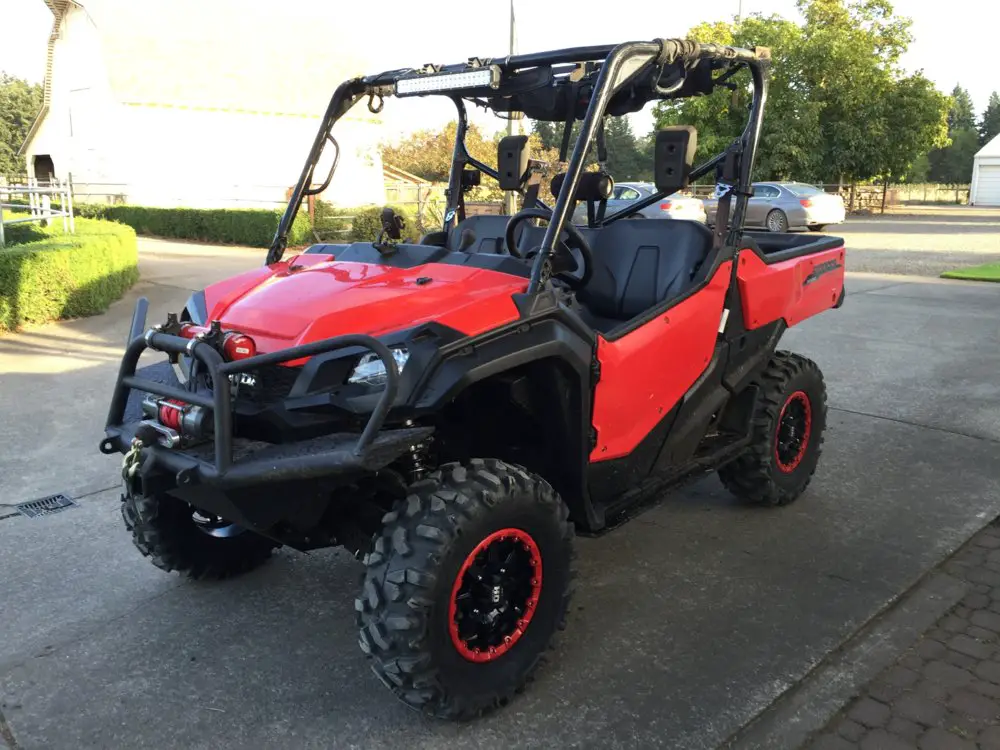

Ordered ONE 28" Roctane (as a spare, IF it didn't fit right) to check out fitment on my rig... this tire is significantly larger than the stock 27" as You can see. I don't want a lift kit... but wanted something larger than stock ... This looks like it's going to work well.. and i'm ordering the other 3 tires/wheels...
Like the look of the Red Beadlock on this... and as I do have a Trail Armor 1/2" skidplate installed... the one thing I had to do.. was trim it up... which was a lot easier than I suspected it would be (used a cut-off grinder wheel.. and in about 30 seconds had it handled....
Just wanted to post for others who may be considering...
I did go with 14" rims.. as this tire isn't available in 12" rims in 28"x10".. (i'm going same all the way around)..
And, oh year.. because I have the added weight of the Tough Country bumper, and Viper 5000# winch.. i had put the 2" spacers on top of the springs earlier..

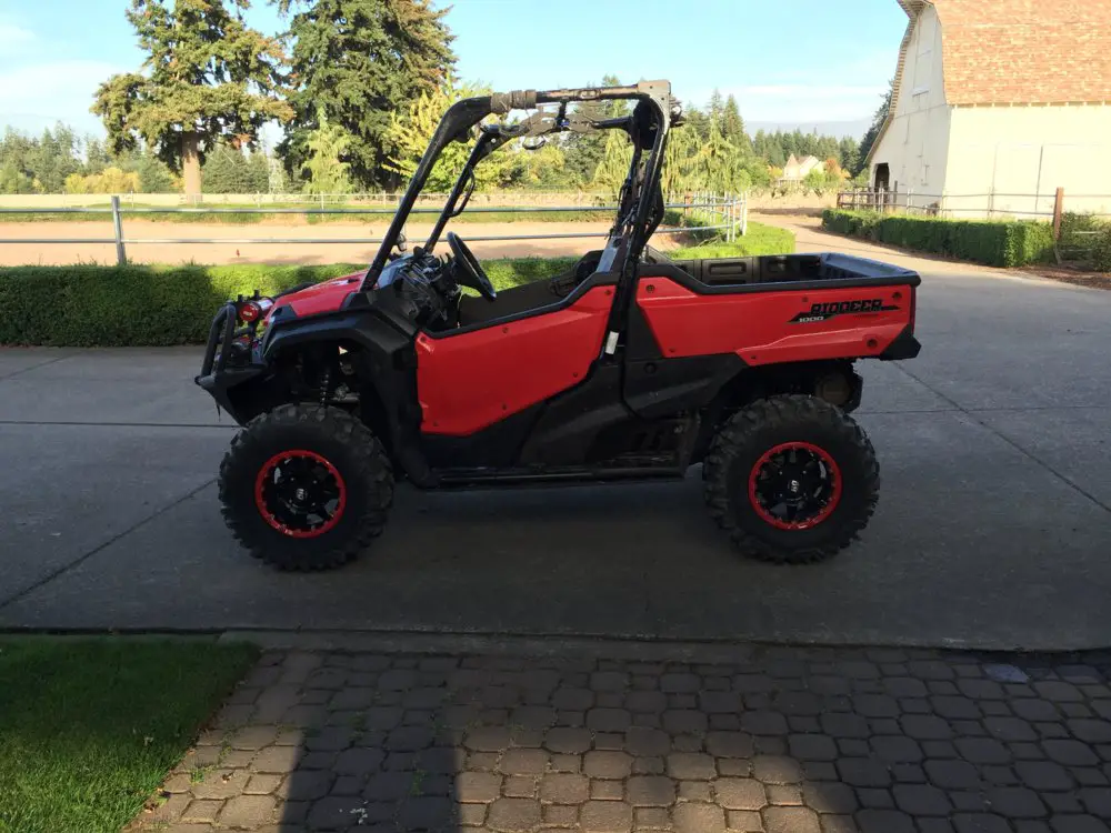

Here is a picture of the tire/wheel mounted (other 3 wheels not here yet) - and a before/after of trimming the Trail Armor skidplate..
IMG 5918 IMG 5920 IMG 5922
